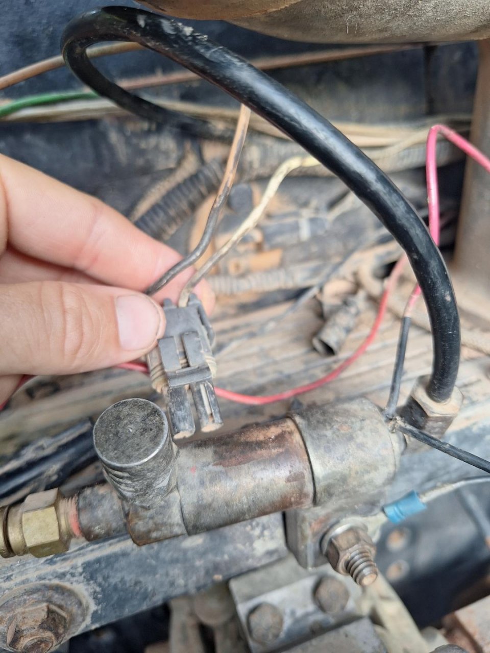

    little update, ive got most of the components in the mail and working a gameplan to get them on the truck. so heres the dilemma ive run across and trying to see if i can get some insight. i have bought a wiring diagram for this truck years ago, but it doesnt seem to be matching up exactly.
    so, problem 1, the compressor clutch wire. book shows it to be black, connected to light green at some point, but ive pulled the harness loom all the way back to the ecm connector and there is no black, only a green in the compressor area (you can see the green wire in the pictures attached), but there are no numbers stamped on it like mentioned a few posts back.
    problem 2, ive come across 2 plugs hanging around im trying to get cleaned up, they are right where the fan clutch solenoid is mounted. im absolutely convinced one plug is the fan clutch solenoid (mine is wired to a toggle switch currently), the other plug im not sure. however, again, the diagram i have doesnt quite line up.
    the plug with tan/tan is female, with one tan jumping to the male plug next to it (plug im assuming is the fan clutch solenoid), the other tan goes on the front side of the engine to the top passenger side to a switch in the block. the switch is the fan clutch switch (has red, blue, and white wire). it has the part number 1684560c92 on it.
    now, the male plug has a tan/white, the tan is jumped from the female plug mentioned above, the white goes back to the ecm. this plug matches the fan clutch solenoid plug i have seen online. i ordered a new solenoid so i will confirm when it gets in.
    so, assuming the tan/white plug is fan clutch solenoid, what would the tan/tan be? book says ac pressure switch but there is a diagram later in the book that shows both pressure switches under the seat?? and if it is a pressure switch, where the hell does it thread into? i know this post is lengthy but the PO took a lot of short cuts that im hoping to straighten out!

    hope these pictures clear some stuff up, if anyone needs more let me know and i can snap more 1.jpg 2.jpg 3.jpg
