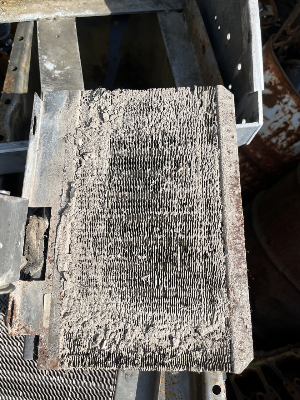

    I am almost certain my old FLD was a yard truck at the end of its previous life due to the amount of dirt everywhere in it. I just cleaned and replaced (still working on it) the entire system. I didn’t reuse anything.
    2F5A209D-E5A7-4558-91FC-218F3FCE2A77.jpeg 87F92E1F-3DAE-409F-96C0-A9EFABC9EB9F.jpeg 9C48DF9D-DC1F-476B-ACF1-CAB41E9E7642.jpeg
