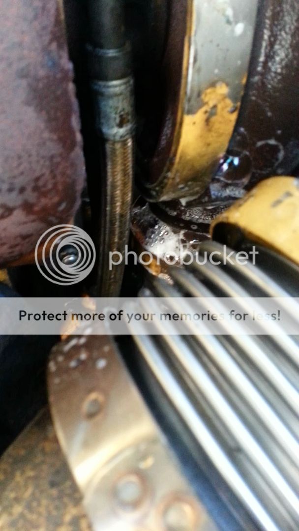

    I did the little soap trick this morning. It has several leaks. Took it up to Cat. He took the pipes and clamps off several times so I'm confused why he was never able to get it right.

    Is it possible the manifold is causing a leak? CAT seems to be stumped so far. They said it sounded like the turbos but they took them apart and they are fine.

  9. Dorsey
    Dorsey Medium Load Member
    412
    209
    Jan 28, 2012
    Florida
    What are the chances this full tilt manifold is just junk and the noise I hear is an exhaust leak?

    Cat should have been able to find an exhaust leak .... I hope..
    Anyway you'll see the soot trail soon if you do have a exhaust leak.

    It ended up being the wrong manifold gasket was used. Still don't have my truck back yet though. The shop that did the botched install job won't refund me the money because they say since it didn't come with instructions from full tilt to not use the stock manifold gasket that they aren't responsible. Then after that i have $408(labor) for cat to take apart the turbos to inspect them(I was pretty sure that was a waste of my time before they even started). Anyways problem solved with a phone call. I would of never thought this would of turned into such a big ordeal for a relatively simple job. I guess I need to grow some balls and do stuff myself. I can mess it up for free myself(labor)!
