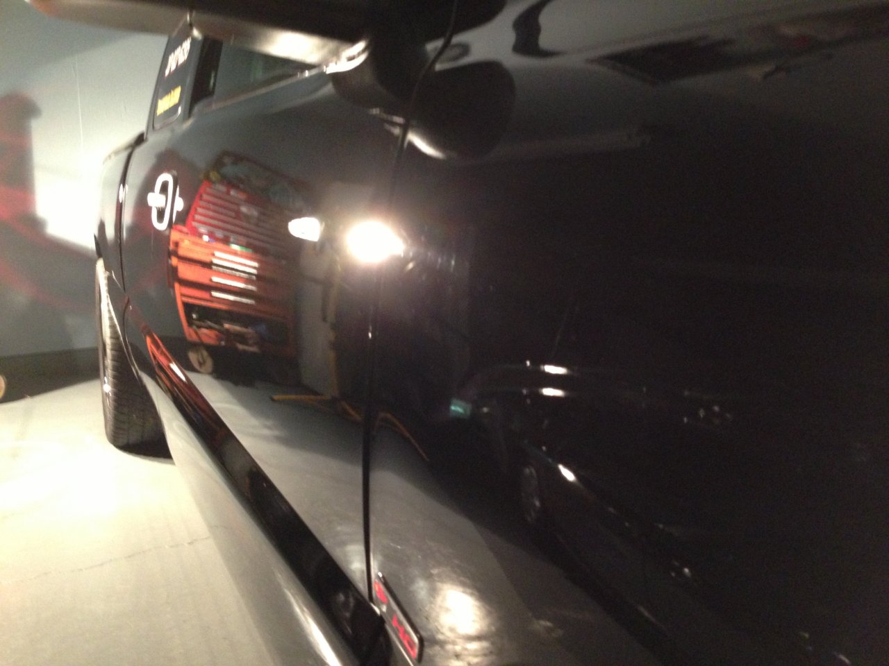

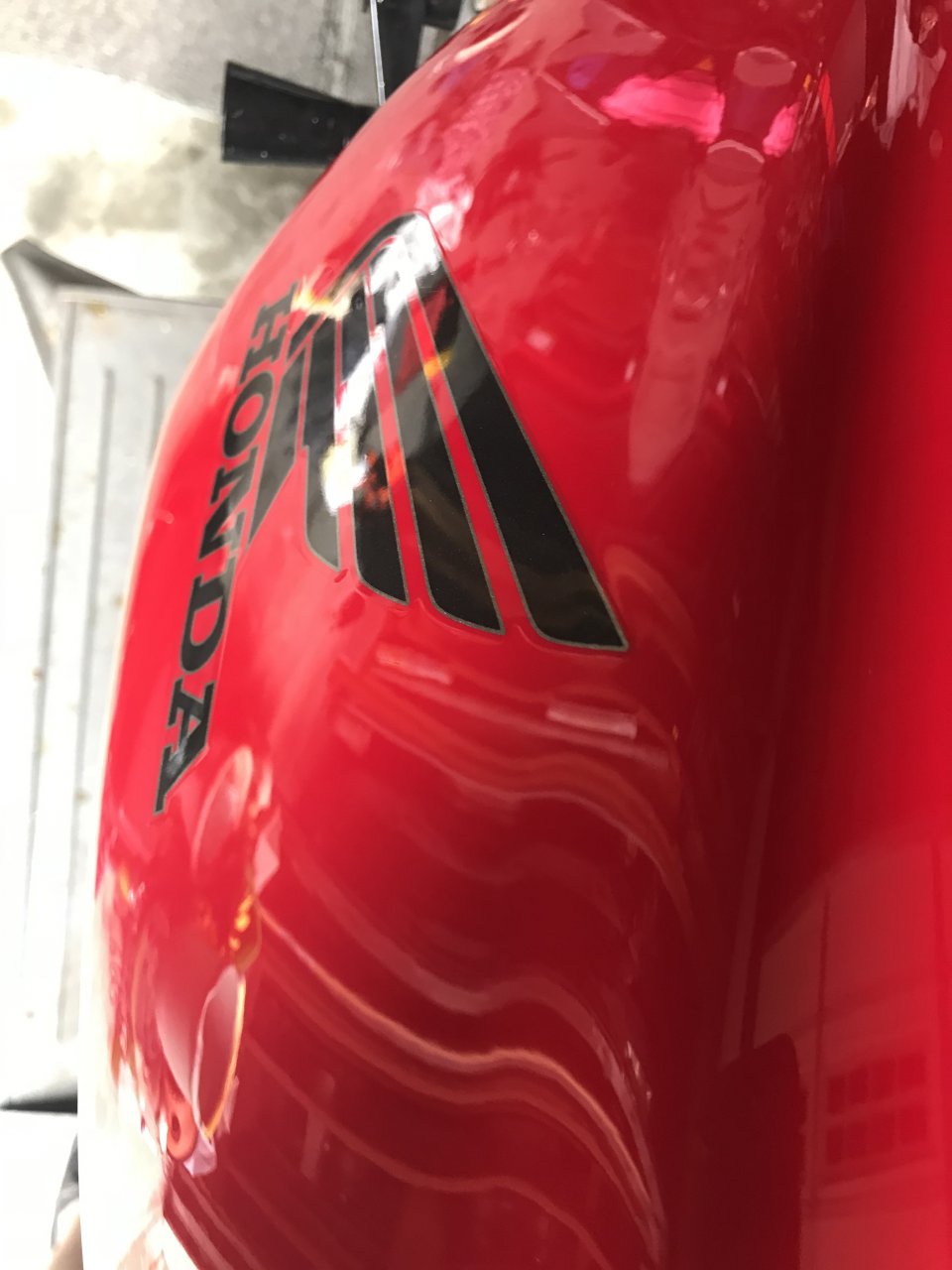

    I’ve used Blue Beacon, for years. They have their own chemists and chemical production. Their stuff has never damaged any of my trucks or trailers. They used to wash my RV and have washed my pickup and box trailer. I’d suggest their Rain-X wax. It costs a few bucks, but, it makes an immediate difference. Now, if BB could get all their locations to the same level of quality, it’d be awesome.
    If your paint is faded, stop by an O’Reilly Auto Parts. In their body shop aisle, grab the white foam pad that mounts in a drill and on the bottom shelf grab Meguiar’s Glaze. Spend some time on your paint with that stuff and you’ll be blown away by the result. Then, you can use BB’s Rain-X wax to maintain the shine.
    Just a couple things I’ve polished out with a foam pad and glaze.
