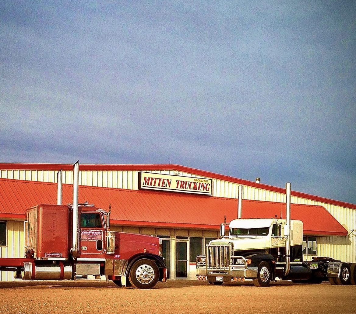

  8. Long FLD
    Long FLD Road Train Member
    13,020
    54,661
    Mar 4, 2015
    Depends on the state and what states you run in. Out here where people add lift axles and stuff nobody seems to care about the truck rating. My brother’s Classic in the pic was a single axle out of Cali when he bought it and was built to a tandem. He never had any issues with it in the Midwest.
