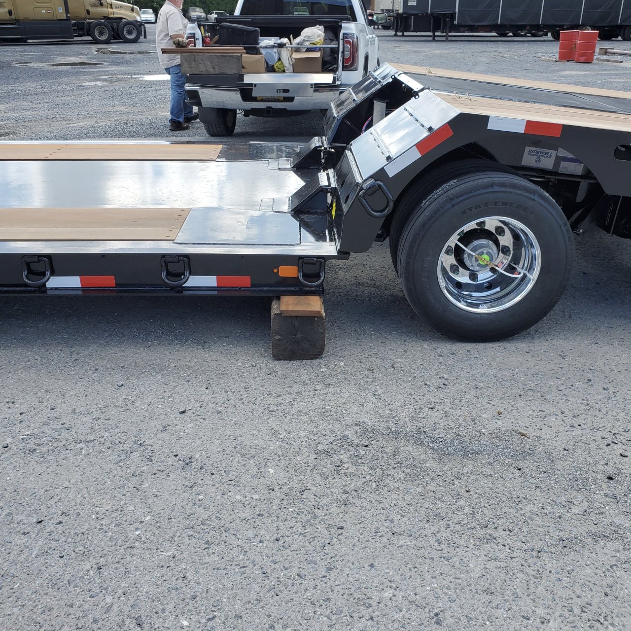

    Xl trailers have the back deck higher at the front than the back so you need a heavy load to level it out, run the suspension low with a light load and back axle won’t air up.
    My next trailer will have a shimable back deck.

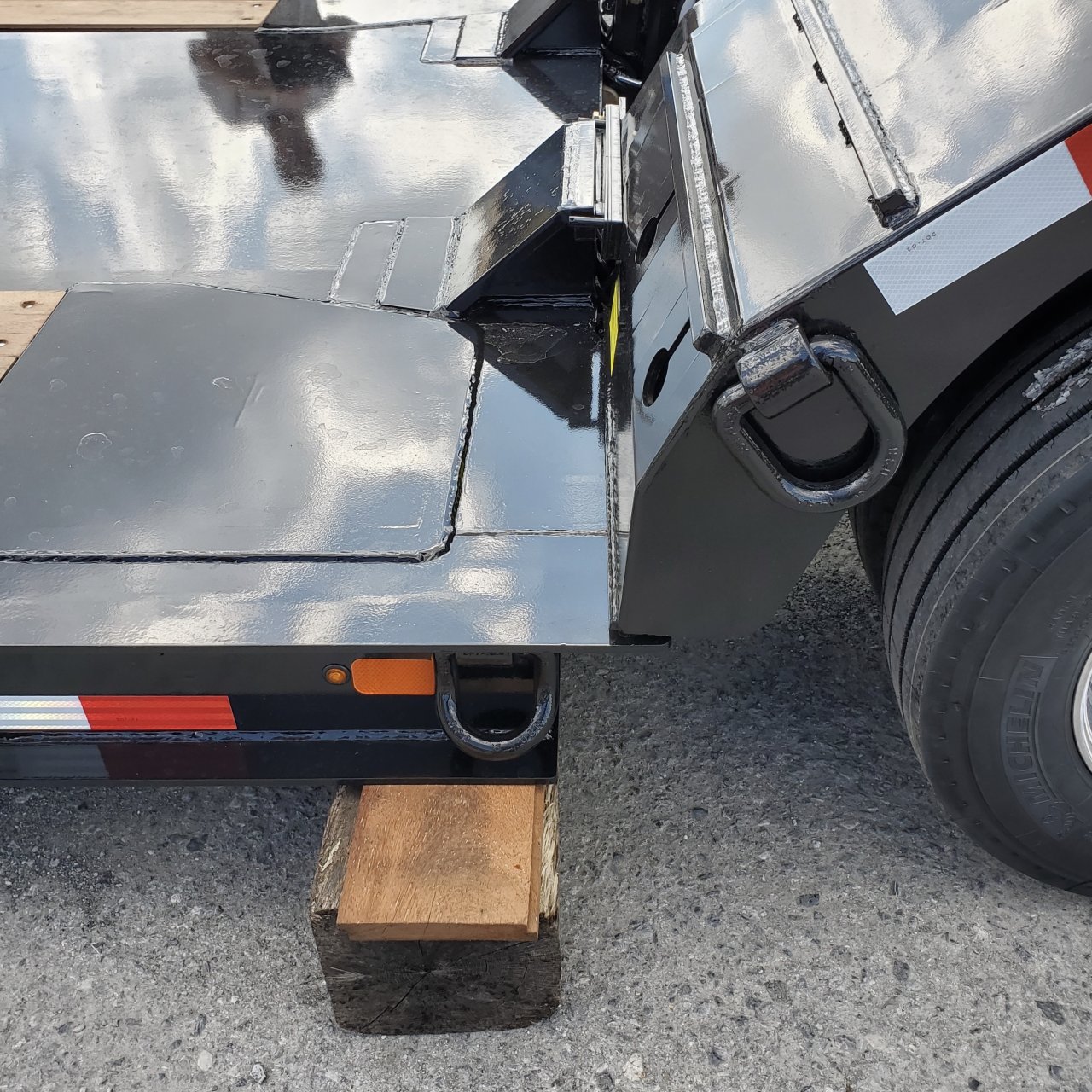

    This is how you get the back level for light loads. This is how my new trailer will be setup.

    No, pic is a 12” Transmaster, 8” thick deck, they have engendered a 6” thick deck for me.with 1 3/4 inch of camber.
    I want a real 10” deck height, xl 10” is closer to 16” with all the camber the put in it.
