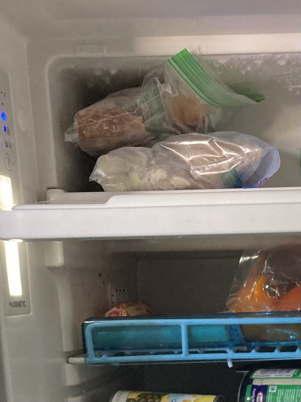

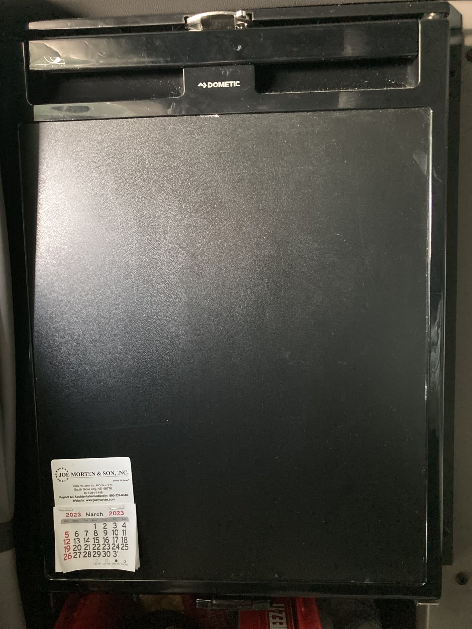

    I run fridge/freezer, bunk heater, and charge all my electronics for 10 hours on four batteries. No issues.

    What type of freezer?
  8. Short Fuse EOD
    Short Fuse EOD Road Train Member
    2,791
    8,764
    Jul 29, 2015
    Midwest
    Dometic

  10. LoneRanger
    LoneRanger Road Train Member
    3,700
    9,629
    Jun 3, 2018
    Dometics are super efficient. They even run on 12v for a few days before batteries run out.
