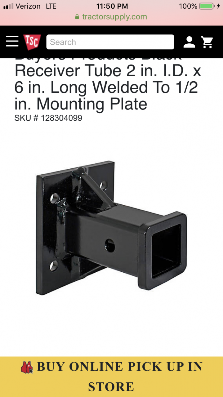

    You can buy this at Tractor supply. Bolt or weld it to your rear most cross member.
    *if your going pull to pull a lot of weight then you best reinforce that cross member.
    This is what i run on my truck. I originally did it so i could use a car dolly, then i started using it for a whole lot more
