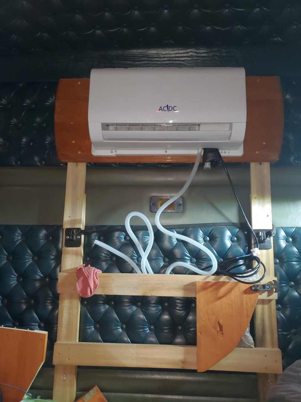

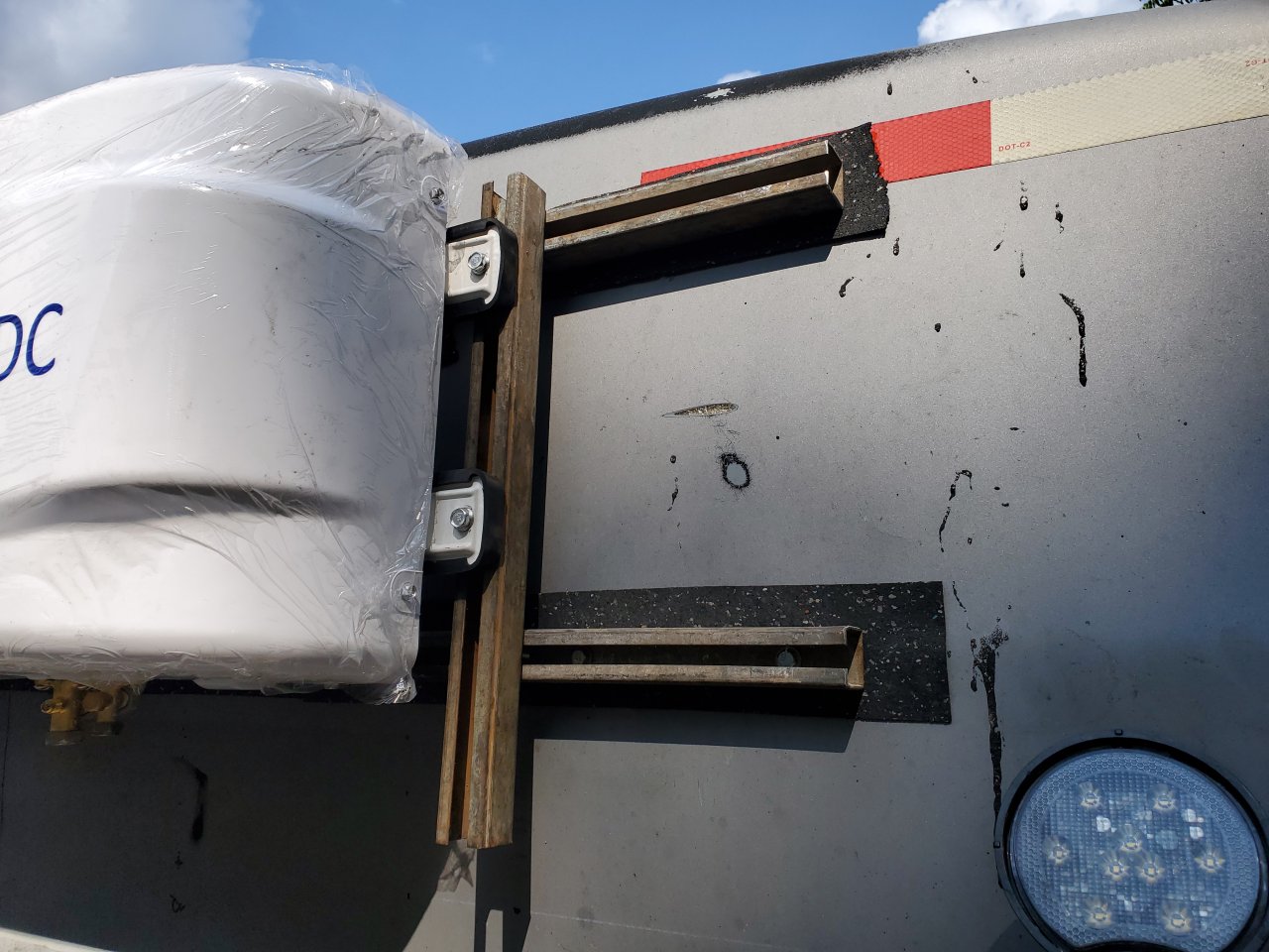

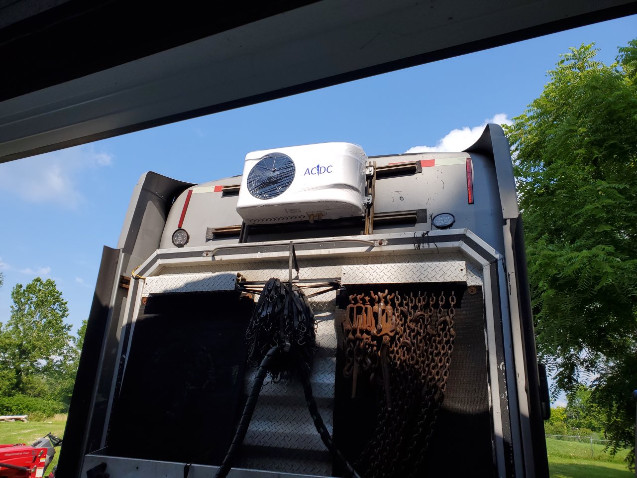

    Me too, supposedly a 20 seer rating, and straight from 12v with 134a, they claim 8 hrs is 300 AmpHrs, ill certainly be testing it, but update, pouring sweat and close to time to start grill, but outdoor unit is up
    Worst case i can take stuff with me and finish on the road now, best case i finish up and roll out with it working in the next 5 hrs (It wont be best case for sure)

    Update, poked at the inside, already had the flip down desk frame down low, had an old living room end table top, found good anchorage in the top and supported from the bottom where the desk frame is attached to the aluminum studs.
    Gonna use the light hole to run the cables through, but packed everything up and gonna do that tomorrow i hope. From here on out it should just be cabling and hose management

    A piece of Armatex like they used on a/c lines makes a good grommet. Sell it at Home Depot. Kind of pricey, good stuff, keep the lines from sweating. You probably have some with the kits line set. I see it comes with 16’. Can you cut it down? Or just have to coil it up? You got Me geeked. Bought some 1/2” aluminum channel today. Going to make some shelves in my Truck, with 1/2” plywood, going to try to make them removable. Still a rough plan. It will change as I start cutting things. Lol.

    This kit is only 10 foot but yeah probably a good idea to sleeve everything, came with a tiny armatex sleeve for the hole (6"), ill worry about sleeving the lines after i have the cables and hoses routed how i want em though
    Electric i think is 16', but thats almost perfect for how ill be running those, ive got the heavy duty crimp and lugs if i needed to change the length though, that has the split loom on it, impressed with the kit so far, we shall see if that lasts past hooking it up
    Can never have too many shelves for tools :p
