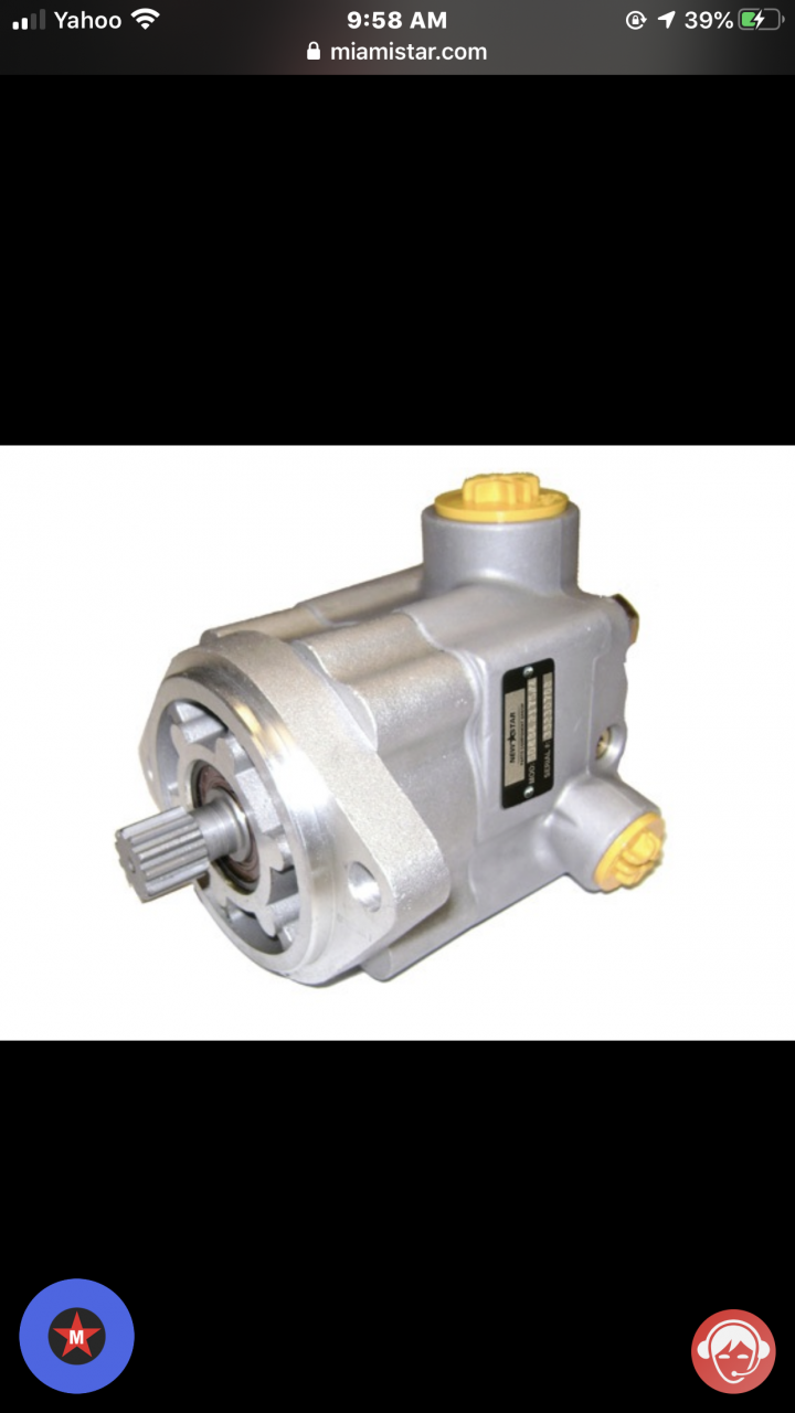

    This is the style pump you will need. Notice the splined shaft, you’ll need the coupling to join the 2 splined shafts in both pumps as well.
    650cat425 Thanks this.

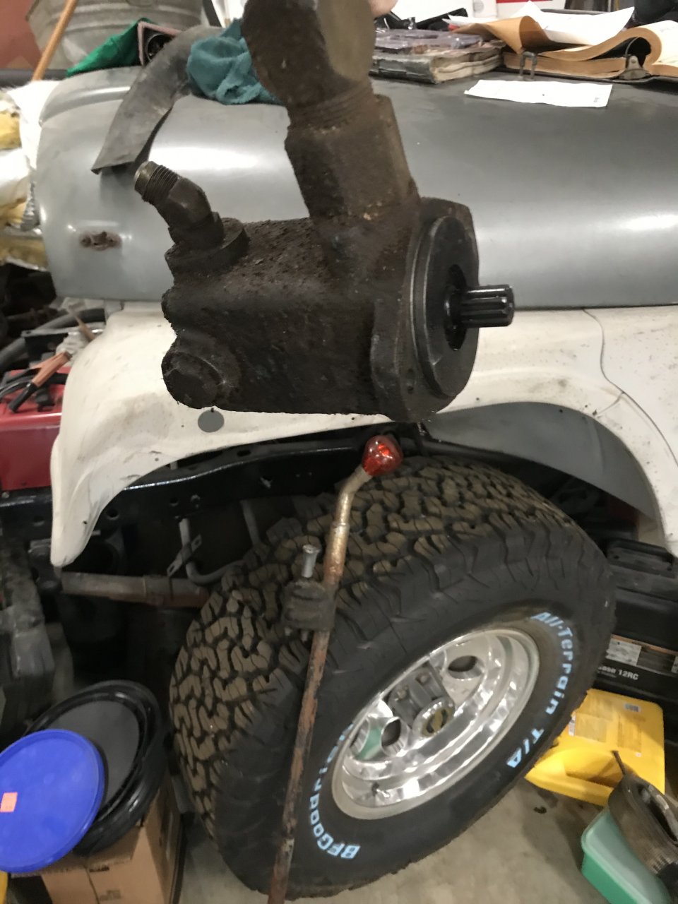

    Is this it?
