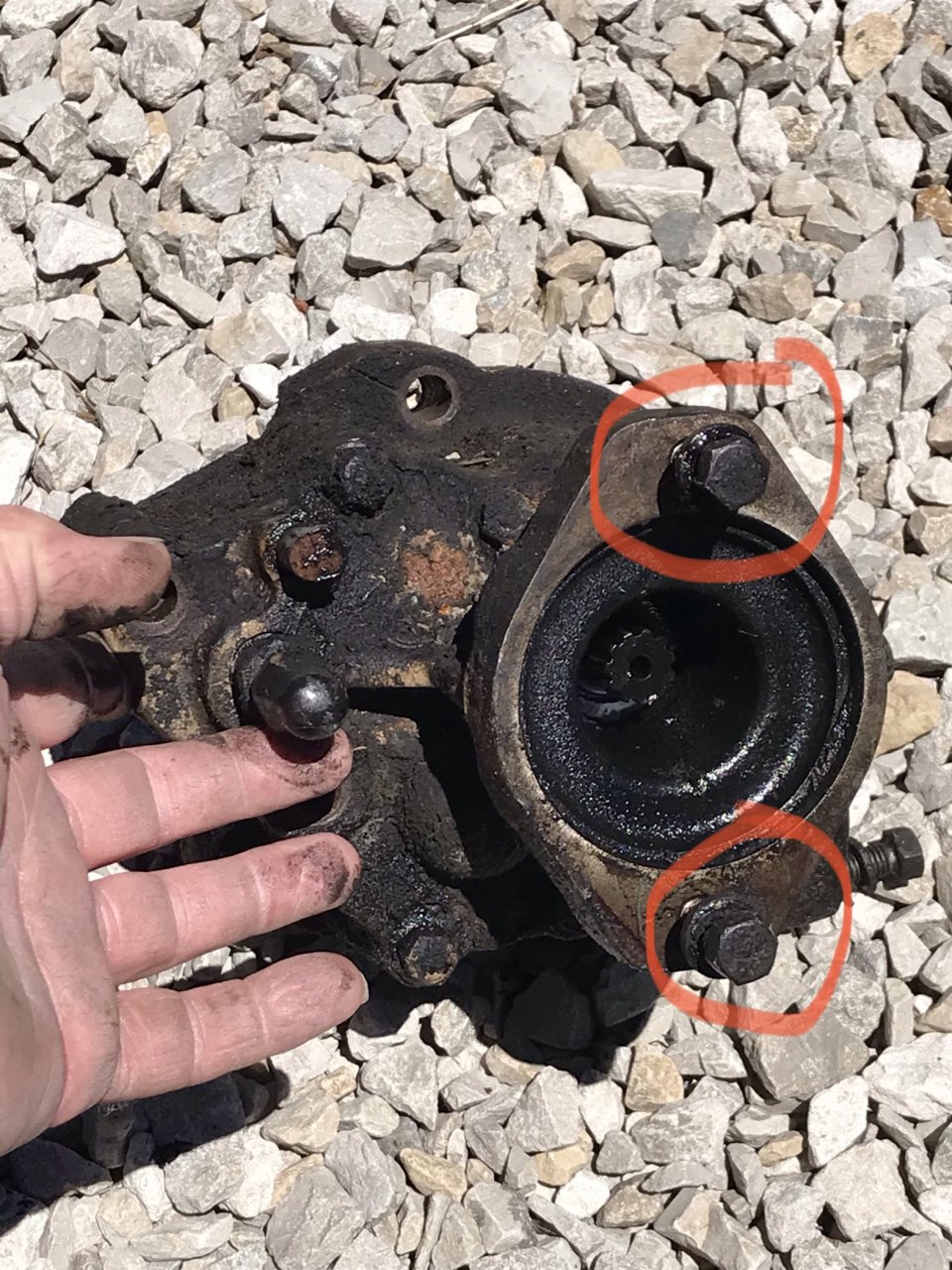

  7. OLDSKOOLERnWV
    20,365
    307,449
    This is a Cummins oil pump, you can see here where the power steering pump piggy backs off the back of the oil pump. If there is not a plate with these 2 bolts in it on the back, then you need a different oil C7E85908-7812-4EB9-B933-16ACDF61C93D.jpeg
    pump. Yes there are 2 different pump housings....
    BoxCarKidd and 650cat425 Thank this.
