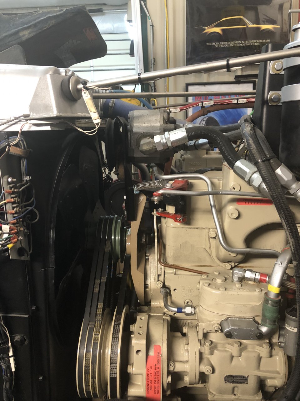

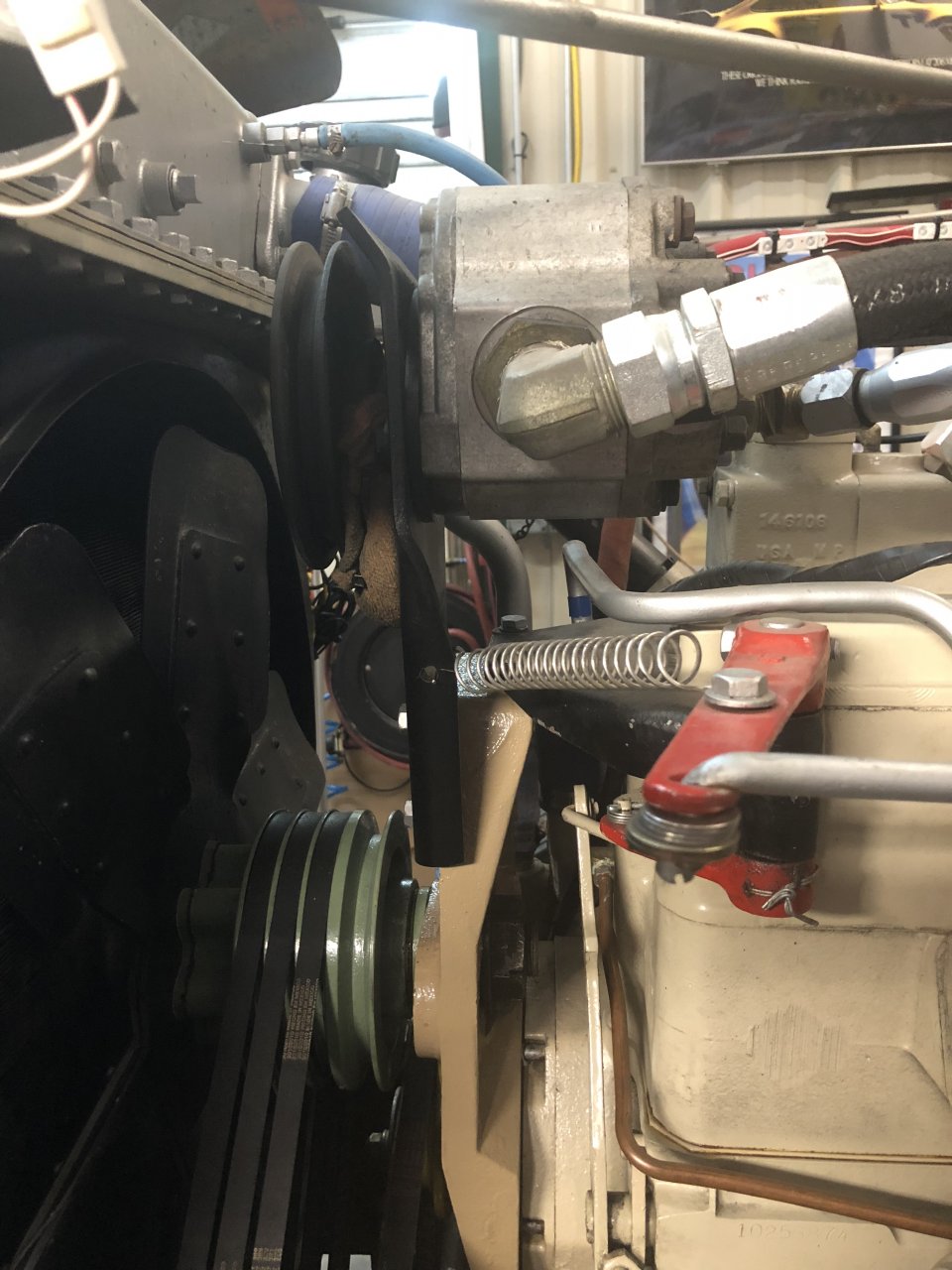

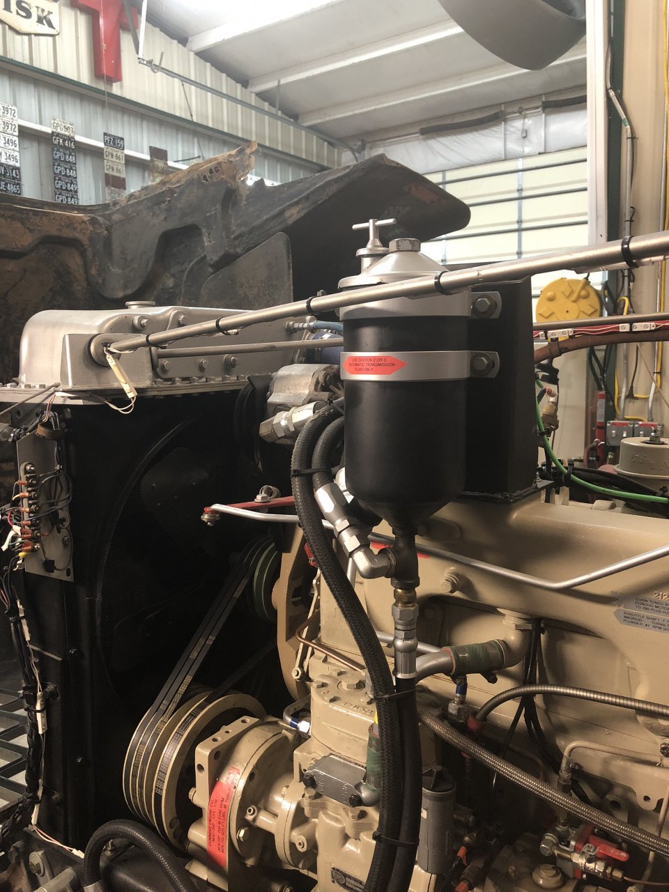

    This is how it is mounted. The belt is off right know because the gear box is leaking and obsolete so in the mesn time I put a Gemmer manual box in its place. Most likely it is gonna be there to stay.

    Nice pictures! There are some army trucks around here with P/S pumps kind of like that. However those pumps mount on the pad where A/C compressors normally go.
    Now the new guys will want to know what the red lever is on the side of the engine. That is warp drive right? Twin sticks to the dash! Switch to the tank with jet fuel!! Then flip the lever that changes the compression ratio!!!
