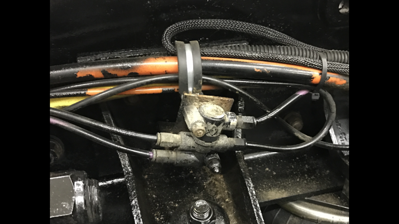

    IMG_9821.PNG This is the valve on my Kenworth, will work on any of them. Notice the bottom line on the right and the top line on the left, are straight across?? Those are going to the airbags. Right side to front axle and left side to rear axle. Bottom line on the left is coming FROM the leveling valve and supplies air to all the bags. The line on the top right comes FROM the cab, when you throw the air operated switch in the cab it pressurizes the top right air line, which allows the bags to exhaust while shutting off the supply from the leveling valve... bottom left air line. Hope this helps. You can install the air switch on the outside of the cab as well. IMG_9822.PNG
    This is a normal air switch that can be used.
    B Mac, Oxbow, Volvo8873 and 1 other person Thank this.
