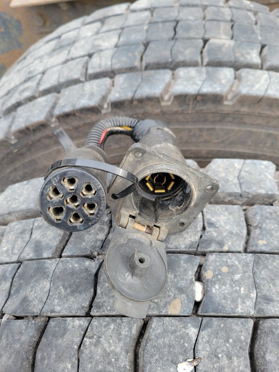

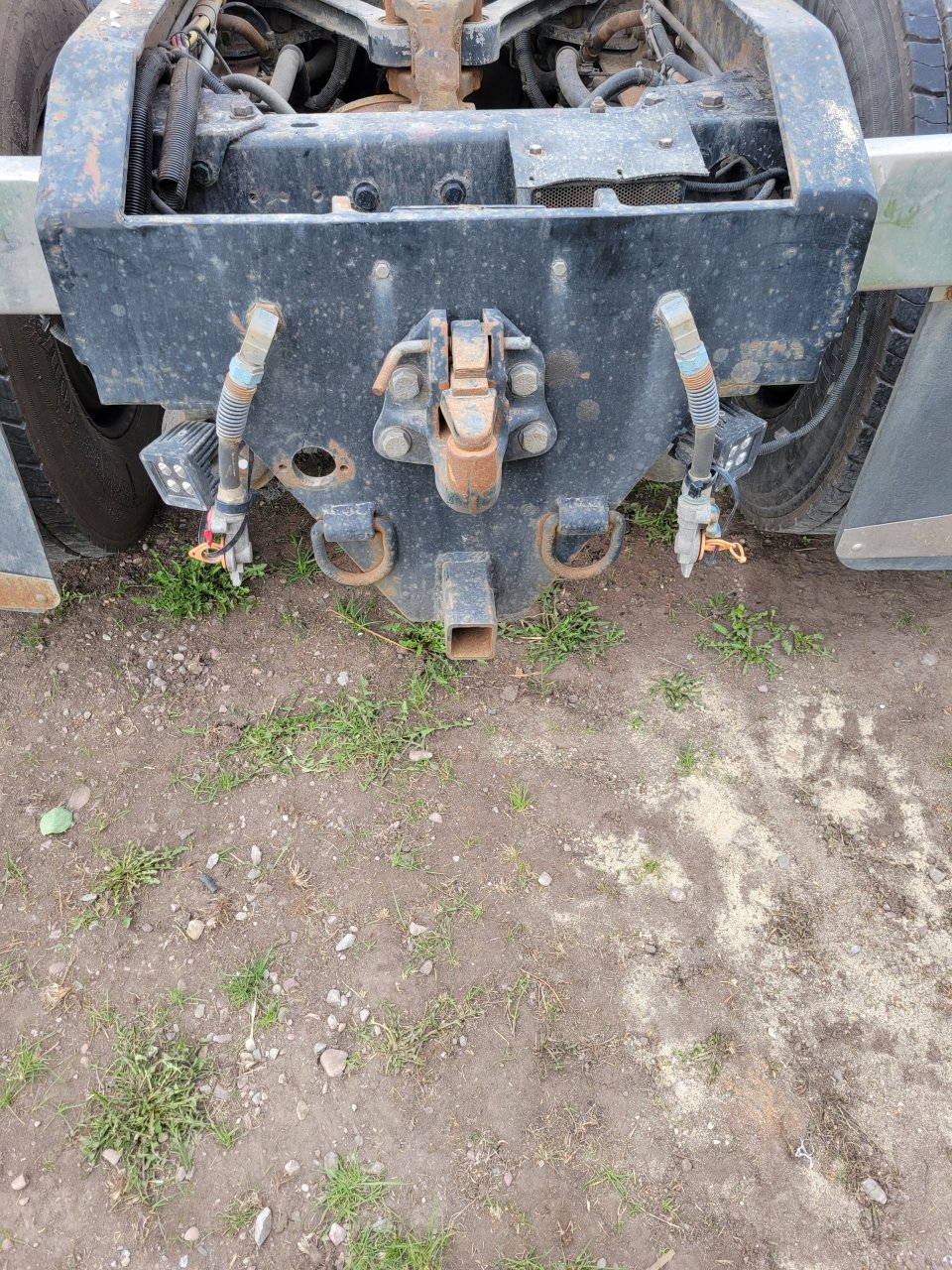

    I did just this and tried to post pictures but can’t seem to. So far as wiring harness, on the rear at your new piece of plate or what ever, place a new 7 wire plug. Splice into your existing wiring harness for the rear brake, turn and park lights. Solder in and wire into plug. Install a brake controller on dash and run the single wire back to your new 7 wire flat plug, to the terminal that coincides with trailer brakes and you are done.
    When pulling off of 5th wheel use regular trailer cord. When pulling off of receiver, plug trailer cord from tag along or in my case goose neck, into new plug and truck on.
