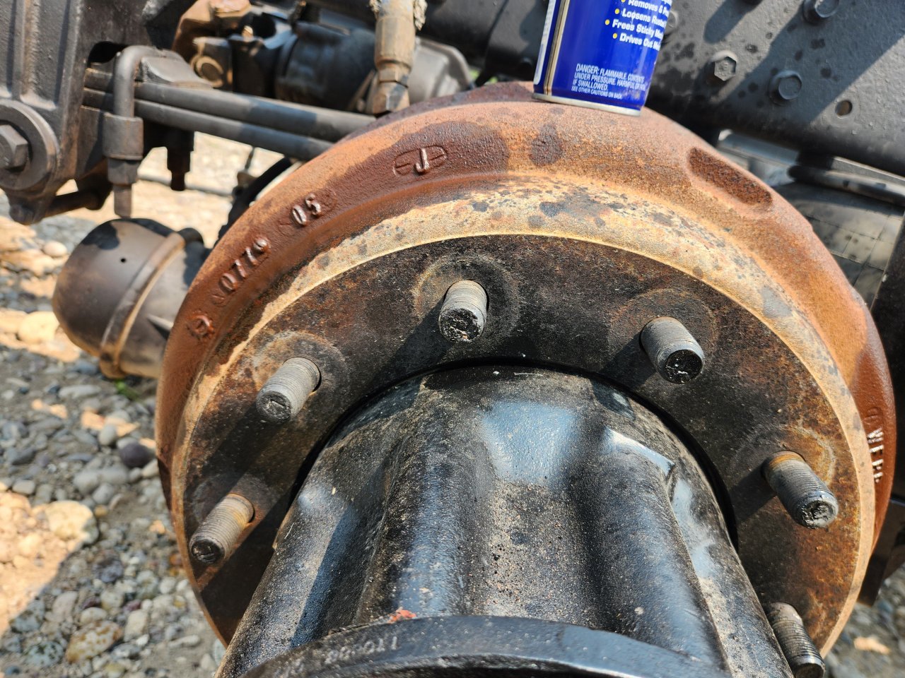

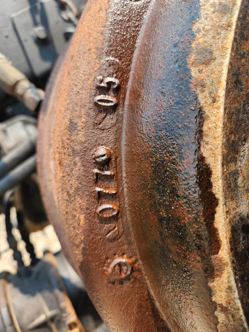

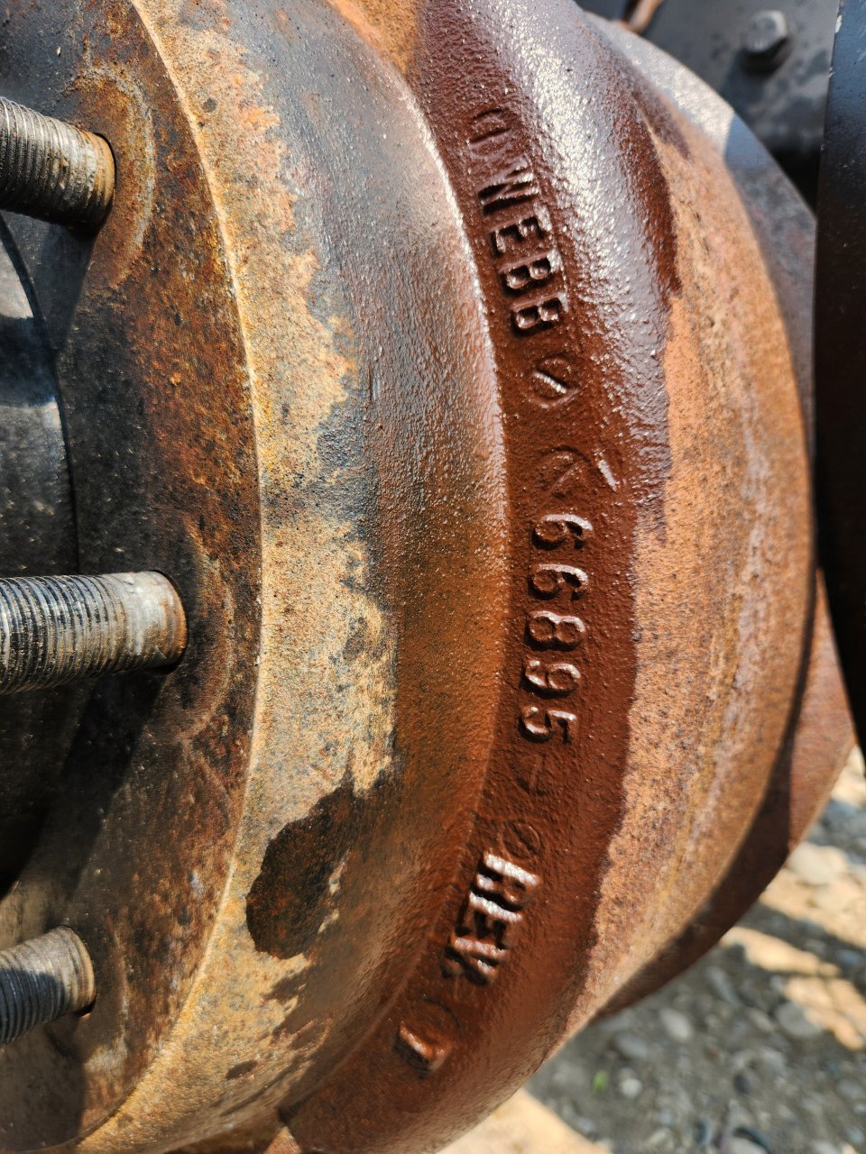

    I got to looking at the drum on the other side. Here it is:

  5. BoxCarKidd
