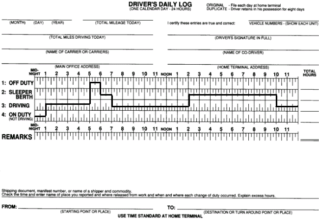

    Here is the deal though the 2 hr break is included in the 14 hrs. As stated in the first example. That after the 8 the 14 is calculated to 5am that is not the case the 2hr break after the 8 is included in the 14 so you must complete the 2hr break before 5am the 2nd day putting the 14 (working)hours potential at 3am. then the 2 hrs putting you at 5am. If you are working or driving after 3am you will be in violation.:biggrin_25519:

    Ok you are confused and this might be tough for me to explain but I will give it a shot. Your message kind of confuses me so I am just going to explain it.
    If you look on just the day 1 example ok: I am posting a picture of it so it's a better way to see what's happening.
    He split breaked so the 8 hour break prior to midnight on the previous day we are not concerned with because the 2 hour break from 5:00am to 7:00 am is working with that 8. So we started our 14 hour from the END of the previous split break (which is the 8 hour break prior to midnight)
    Keep in mind when you split break the 8 & 2 hour break is only going to clear out any hours worked prior to the 1st break. So on the 8 & 2 break you see on the log image I am posting is clearing out all time prior to 5:00 am. Just a food for thought there.
    So you go to the end of the 8 hour break and count over 14 hour.
    Now DOT says if you have 8 hours in the sleeper you can extend your 14 hour by the amount of hours in the sleeper. So I have 8 hours in the sleeper so I get to count over 8 hours. So here it is
    My 14 started # 7:00 am so I count over 14 hours that makes my 14 end # 9:00 pm. Now I do have 8 hours in the sleeper so I get to count over 8 hours from my 14 hour so my 14 hour really ends # 5:00 am the next day.
    The driving time available is figured by adding up all driving time in BETWEEN the 8 & 2 hour break. So in between the 8 & 2 I had 7 hours of driving right?
    So always take 11 and subtract the # you have in between the 2 breaks and that's how many hours you have available to drive.
    11-7=4
    So if I take off and drive my 4 from 10:00 pm to 2:00 am I must stop that truck. However if I decide to fart around I really have up until 5:00 am to do that 4 hours of driving time.
    You never can split break if you just drove 11 hours because 11-11=0
    It's nothing but a pattern basically.
    You can say if you are coming off your 8 hour break (meaning you have your 2 hour break prior to the 8) you can go to the end of your 2 hour break and count over 22 hours it would be allot easier! However lets say you took 8.5 hours in the sleeper then you could really count over 22.5 hours from the end of your 2 hour break.
    If you are coming off your 2 hour break go to the end of your 8 hour break and count over 14 hours and that's when you MUST stop driving.
    You will notice that's because there is no 8 hour sleeper break to extend the 14 hour.
    Read my thread I reposted and this and maybe it will help clear it up.
    Did this help answer your question?
    Remember DOT says in a 14 hour period you have 11 hours to drive. If you look between 12:00 am to 2:00 pm I did not drive over 11 hours and I did not drive passed 2:00 pm. I took an 8 hour sleeper break I have to be good for something rest wise so they allow you to drive some more.
    All driving time must be cleared out by a 10 hour break. If you notice I have a split 10 to clear out the driving time from 1:00 to 5:00 am. the driving time from 7:00 am to 2:00 pm does not get cleared out until I have the 2 hour break to follow my 8 hour break.
    I think you are focusing on the fact your lines 3 & 4 shouldn't total more than 13 or 14 hours and this can cause you some serious log violations. Have you called your log dept to see how you are doing lately? :biggrin_2559: Not laughing at you but laughing at us:biggrin_25521:

    NO NO NO!
    Your 14 hour starts from the end of the 2 hour break!
    See the 8 & 2 is clearing out the time you worked prior to the 2 hour break. Everything after 8:30 am is still counting against you or for you (8 hour break is for your good).
    So you count over 14 hours from 8:30 am which made your 14 originally end # 10:30 pm. Now because you have 8 hours within the 14 hour period you get to extend your 14 hour by 8 hours. So you count over 8 hours from 10:30 pm which makes it end # 6:30 am.
    Your drive time available by my example is and yours is going to be 6 hours, however I must complete that 6 hours before 6:30 am the next day. If I hurry up drive my 6 I can take my 2 and be on the road again.
    So day 2 you can see I drove until 4:00 am. Now my 14 hour is going to restart at the end of my 8 hour break so count over 14 from 10:00 pm (day 1 log) which makes your 14 hour end # 12:00 pm (which I put the mark # 12:30 sorry it should be 12:00 either way you are not in violation because we was not driving passed that 14 hour and I took my minimum 8 hour break before driving again)
    My driving time available was 5. I even stopped to eat/load etc for 1 hour.
    After my last 8 hour break I will go to the end of the 2 hour break and count over 14 hours and extend that count by 8 hours or you could just count over 22 hours from 6:00 am on day 2 and that's when your 14 hour will end.
    Keep reading this and drawing some examples out until you get it! It helps to draw the picture as to try and just read it.

  11. LogsRus
    LogsRus Log it Legal
    2,589
    358
    Nov 23, 2006
    Indianapolis, Indiana
    No wonder you didn't get me l.o.l.
    here is 2 day continous split logging that is totally legal.
    I talked about the pictures a few post up just forgot to post the pictures I guess:biggrin_25518:
