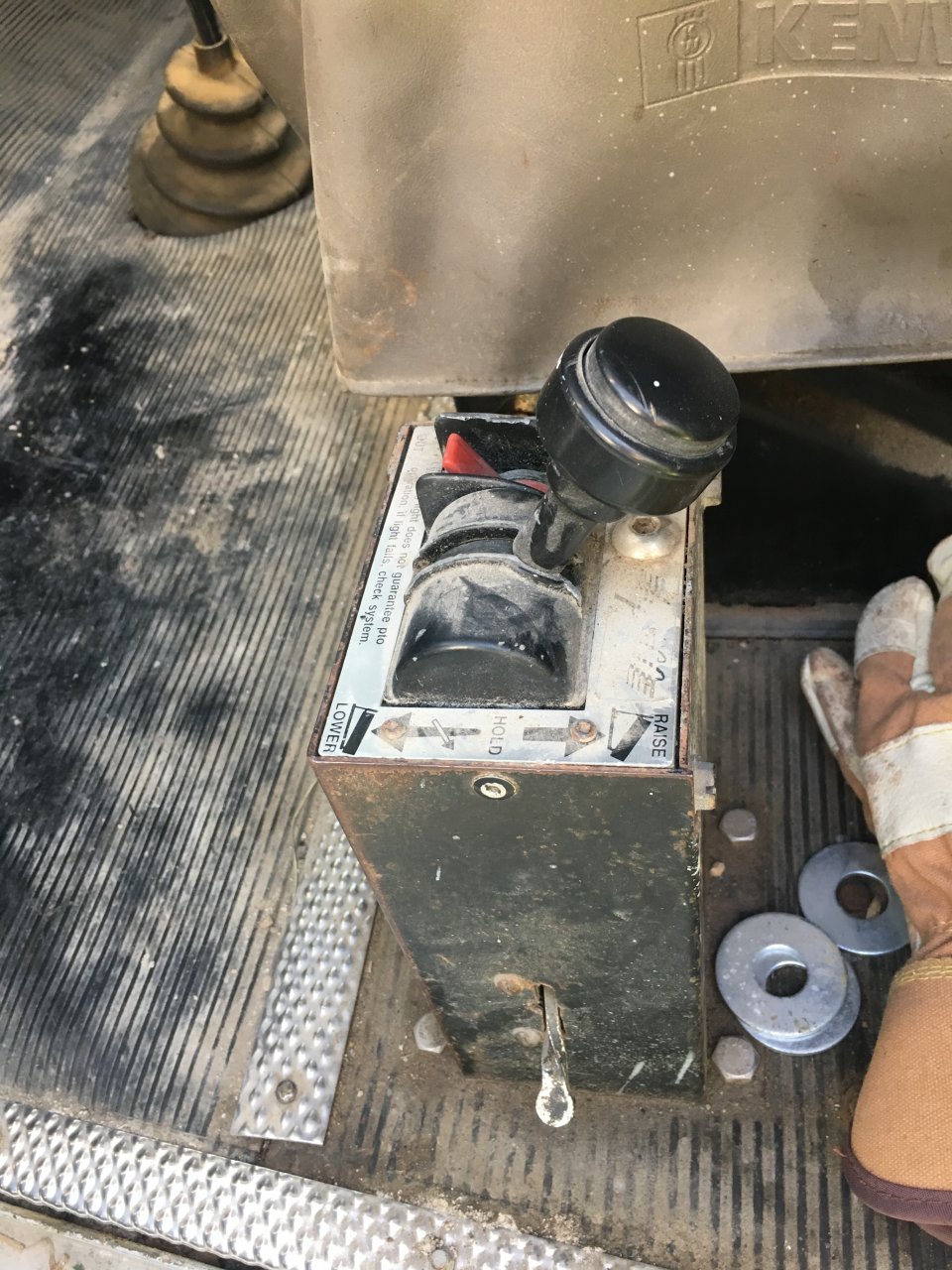

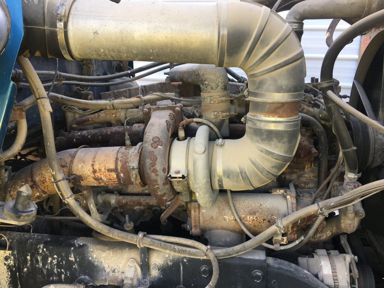

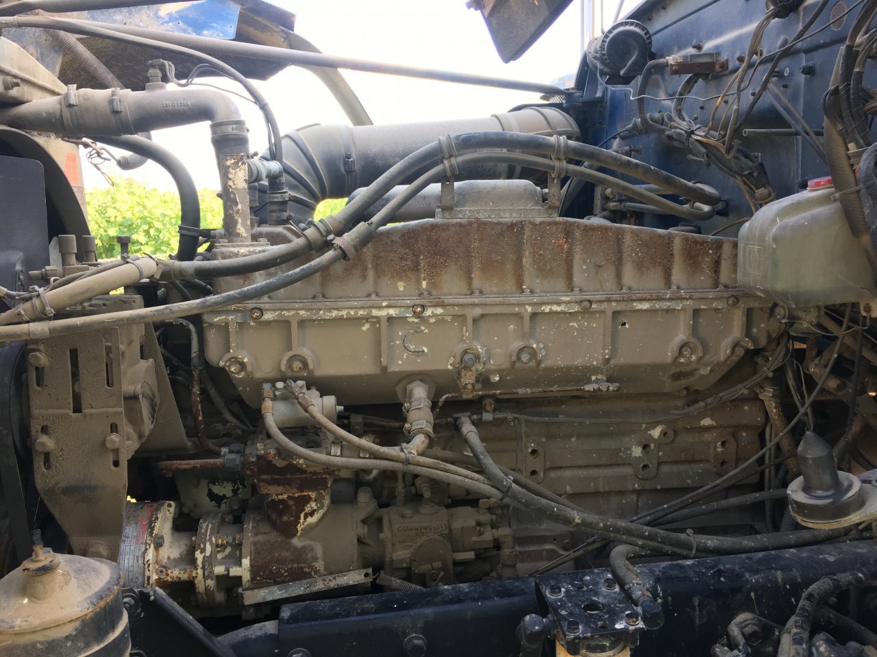

    71A9AB03-0DC3-4093-B604-DB54B1B6E3E2.jpeg 9DA6A8E3-40B5-4C33-888C-40F615BEF198.jpeg 85ED85C2-FC32-4E31-970B-1D165850EB9E.jpeg 02FDA8B4-A98A-473C-9D50-C68030F58B9E.jpeg 8C9B504F-C43E-4385-86BB-FE174C952226.jpeg 4486ECAA-E36E-4FA1-AD00-69C4D2450BFB.jpeg D243615B-C60E-48A1-9E22-98B6E84F98ED.jpeg 54AF5CA7-F554-4F15-AC06-71FC5BC1ED7A.jpeg CF62DEF2-146B-4F44-9FE1-B196ACD30FE0.jpeg 1B634C0C-1935-4457-B055-BEA22DC882CE.jpeg

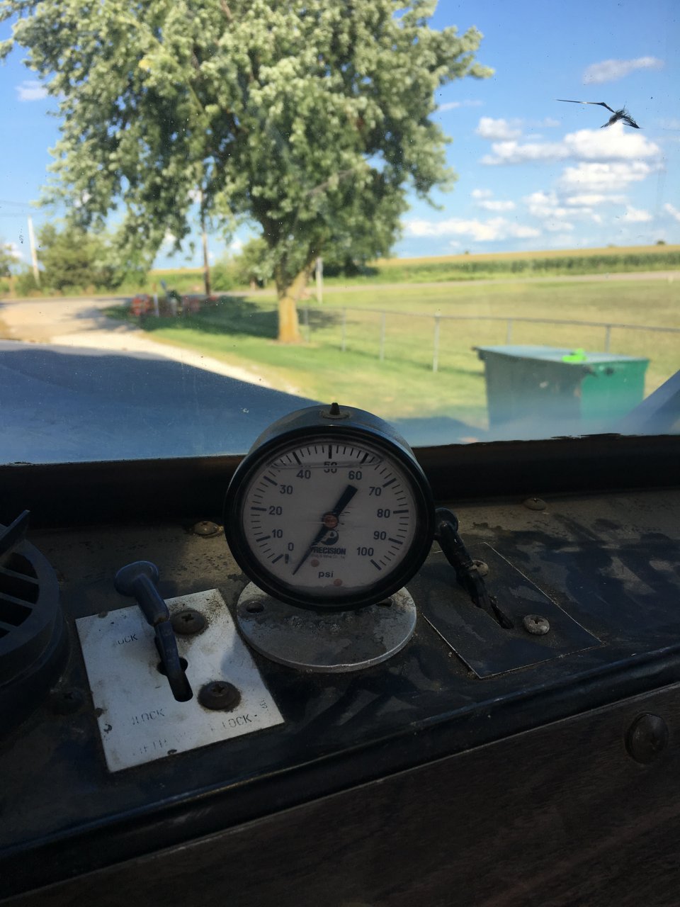

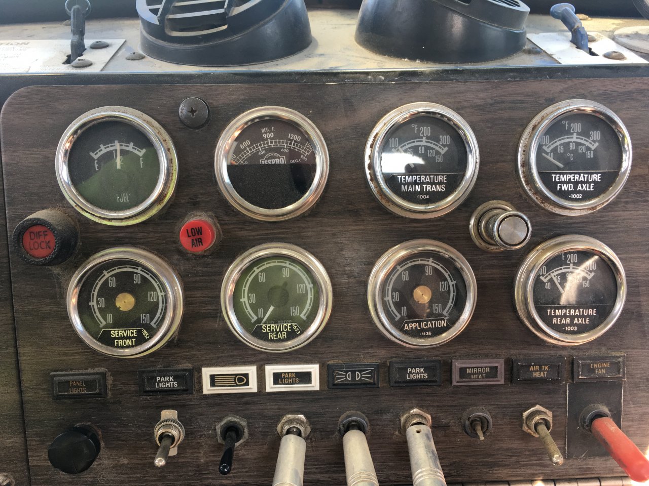

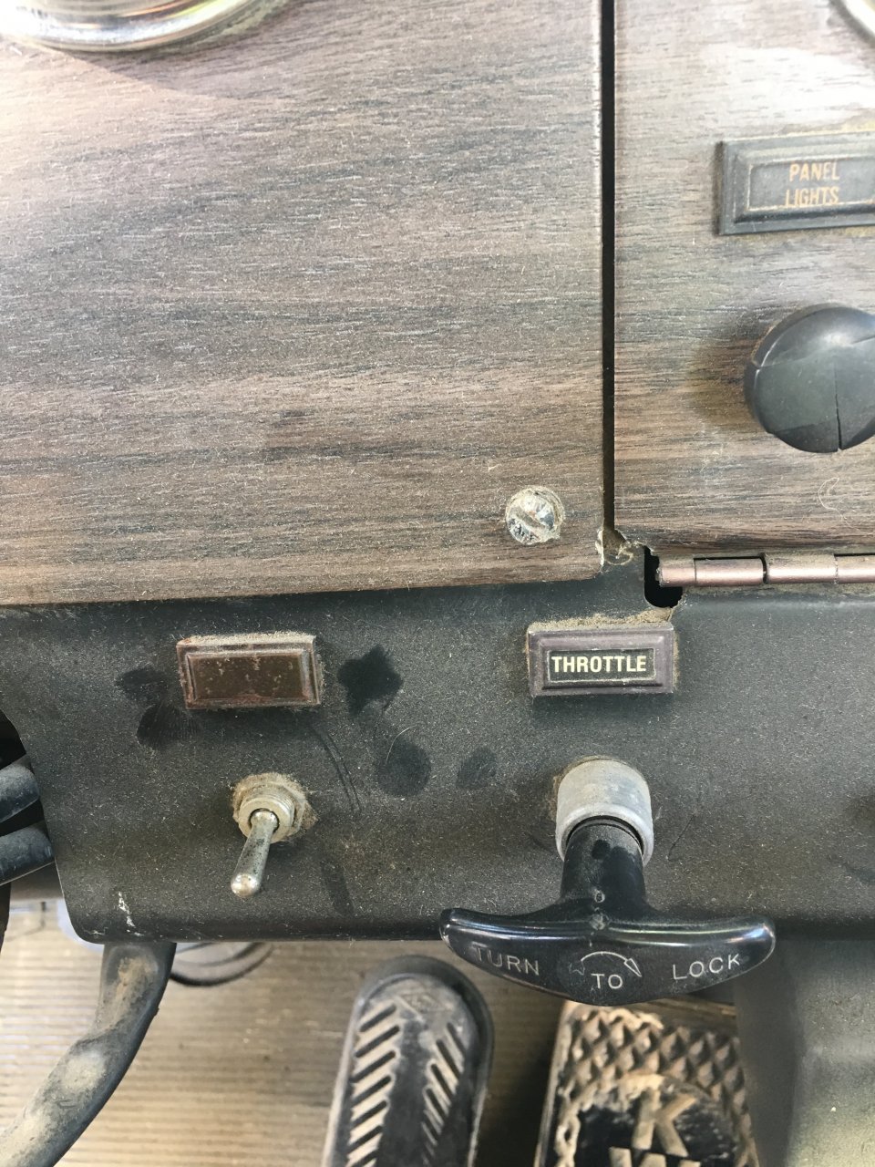

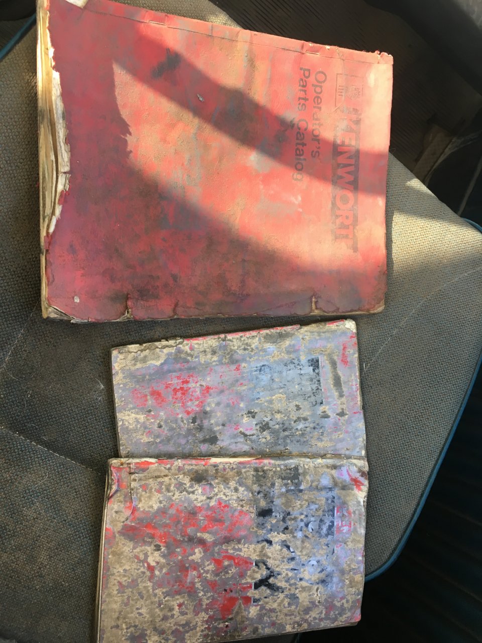

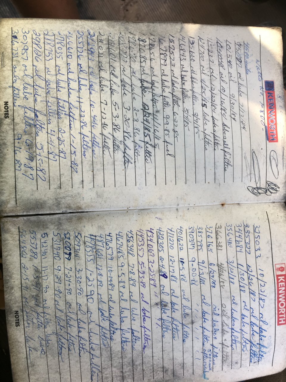

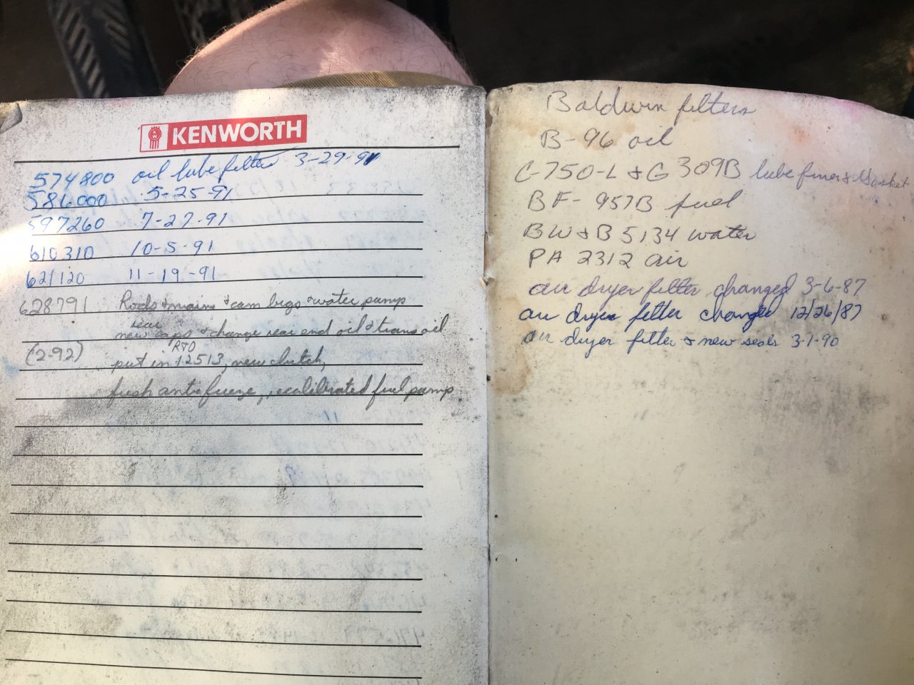

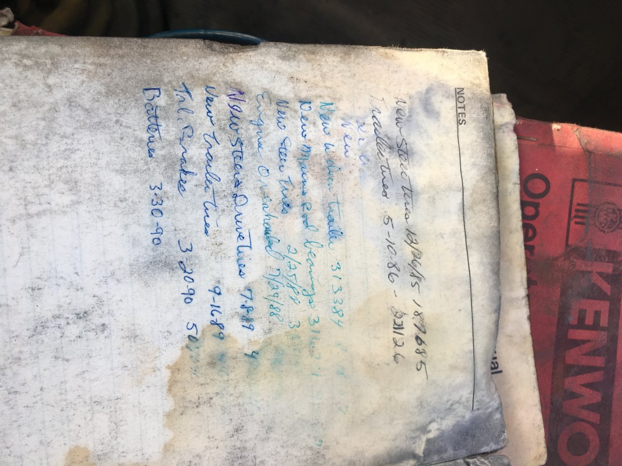

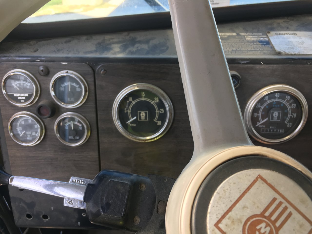

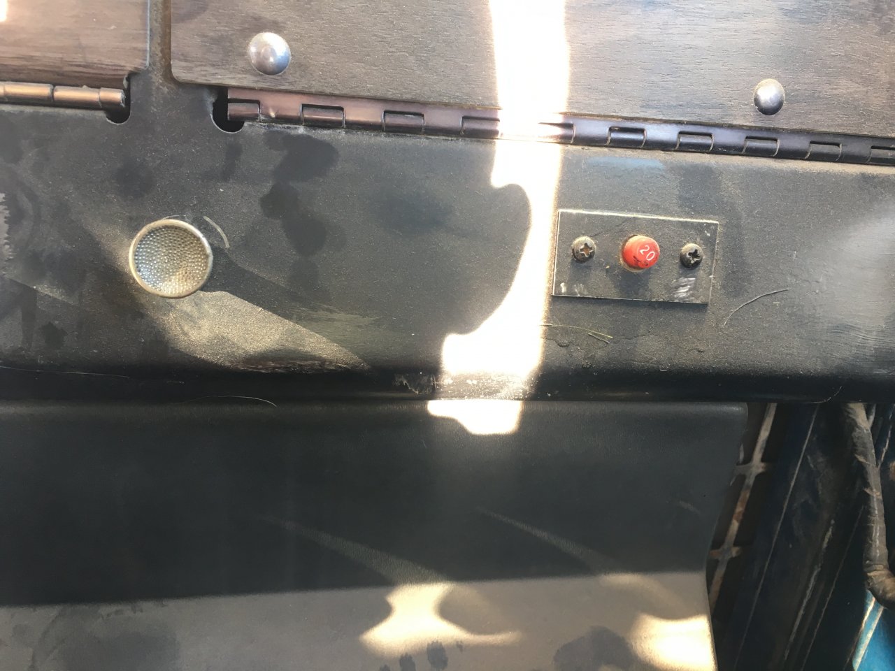

    Here ya go sir. Also attached some more pictures and also a pretty cool find under the passenger seat (extensive records including a motor overhaul done in 1992 lol and what I believe is the original build sheet) not 100% sure what some of my switches and gauges are for specifically the gauge on top of the dash and the knob and switch by the glove box. But also the switch by the hillbilly cruise

    I bet the gauge on the dash is tied to your rear air bags. That and the PTO control is a pretty good clue that they were running an end-dump using a wet kit to run the dump and the gauge to help guess on how heavy to load the trailer without being overweight. There may even be a second psi gauge to read the trailer air pressure thru a dis-connectable air line. That is how we ran our dump. Is the 5th wheel pinned or pinnable?

    Do you happen to know what the switches and the knob is all for that I pointed out earlier? Or does your truck have the same ones?
