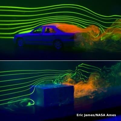

    'Comparing the laminar and turbulent airflow around a car and a truck.'

    I always wonder why when some trucks pass me my truck will shake, other times larger or faster trucks have no effect.

    They say it's especially noticeable in crosswinds. Like a venturi effect, methinks.
    "In fluid dynamics, an incompressible fluid's velocity must increase as it passes through a constriction in accord with the principle of mass continuity , while its static pressure must decrease in accord with the principle of conservation of mechanical energy. . ."
    Fluid dynamics are involved in the study of truck aerodynamics, as well.
    I've seen a venturi valve used as a kind of 'turbo' compressed air nozzle, that is. It could be that with uncompressed air, the drop in pressure sucks adjacent vehicles into the gap (or there's both a push and pull to the turbulence).
    Anyway, they list something like that as an example of Venturi effects: "Large cities where wind is forced between buildings - the gap between the Twin Towers of the original World Trade Center was an extreme example of the phenomenon, which made the ground level plaza notoriously windswept. In fact, some gusts were so high that pedestrian travel had to be aided by ropes . . ."
    It's also called a gap wind.
    "In some introductory textbooks and in the 'common knowledge' of many meteorologists, gap winds are explained by the 'funnel' or 'venturi' effect, in which the strongest winds occur in constrictions. Although funnel effects can influence wind speed, the strongest winds are generally not in the narrowest portion of gaps but rather in gap exit regions. Furthermore, other mechanisms appear to be far more important in modulating wind speed in and near gaps. The 'Funnel' or 'Venturi' Effect: Only a Part of the Story... Although the venturi effect is often not the dominant mechanism for large gaps (tens or hundreds of km long and several km wide), it can be very important for small scale gaps (on the order of a few km or less in length) where the contributions of the larger scale pressure gradients or changes in the height of near-surface cold air are less important . . ."
