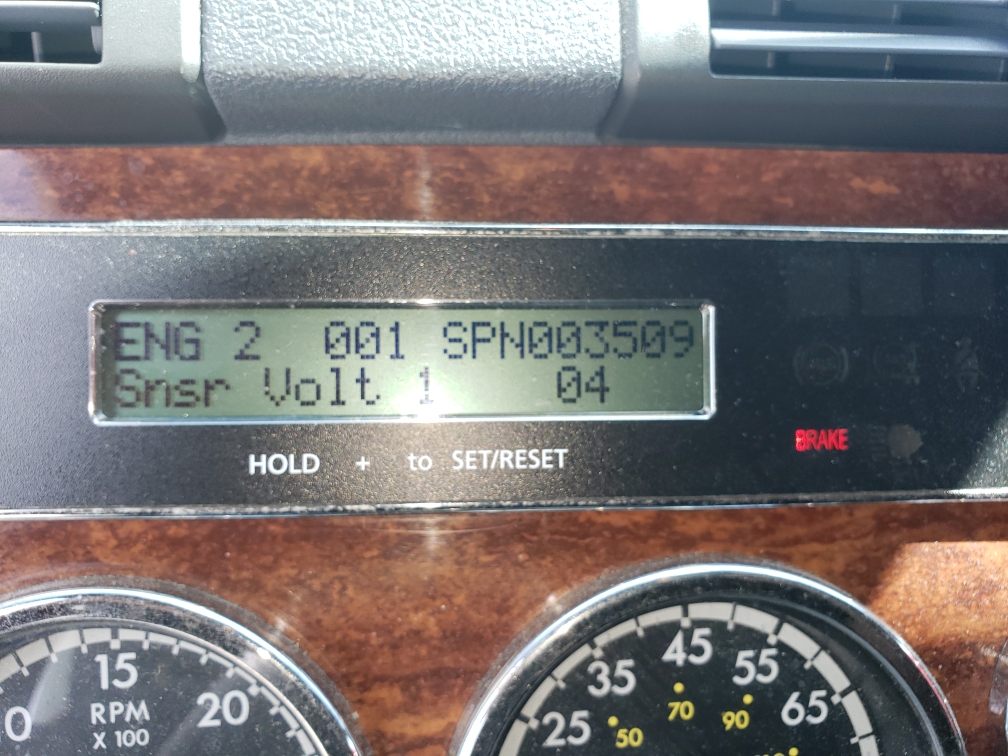

    Hi Guys, can anyone explain this error I got on dash .. right after Truck Wash
    2010 freightliner cascadia - please view Image Attached
    Truck has 750K om engine
    ENG 2 001 SPN003509
    Snsr Volt 1 04
    Thanks in Advance

    Did you get them to wash the engine?

    Maybe should know FL procedure for washing the motor. Some things need to be covered/not sprayed directly.

    Don't wash the engine They get all up in there with the power washer

    A sensor got wet, just wait awhile and let it dry out and the code should become inactive.

    I had 2 Cummins in the past that would do that. Call up a Freightliner dealer and they can tell you what sensor it is. Take the sensor out, the Cummins didn’t even need tools, pull it out and blow it out.

    Wash the engine very often, keep it clean and shiny...Only don't put pressurized water on ECM. That's all. If code poped up after washing fix it. Same code may pop up if you run over water or when rains heavy
