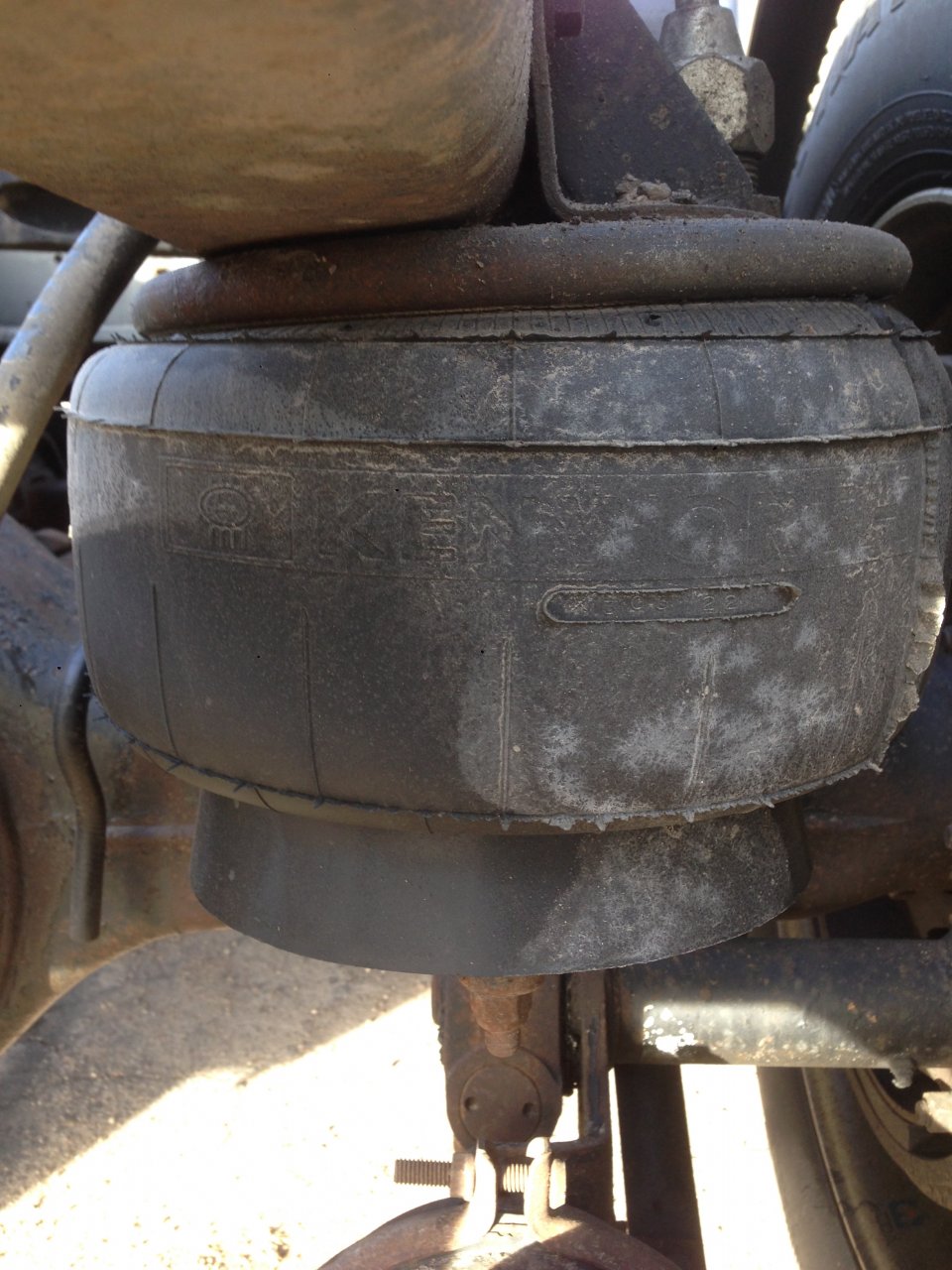

    They are probably inflating with the same air pressure but one is just not aligned. Check cross member for broken bolts or bent. Put a t-square on frame to see if straight. Check and see if saddle bracket is straight. Those saddles are plastic could be the single bolt that comes out 5 he bottom is bent or has the saddle warped.

    From what he is saying it looks like all the right hand side bags are out of align not the one bag. But if it's just the one bag it would be easy to see where the problem is just by removing the bag.

    On the old type you must back off bolts ( you may find loose nuts and bolts) and put a jack or port/a/power to push bottom out then tighten all bolts back up.

    image.jpeg Here is a pic of an airbag on my truck. I replaced them a couple years ago and it appears mine aren't all straight either. It isn't offset as much as yours is in your pic but just wanted to show you another truck with the same setup. It appears the bottom of your air bag plate is off center for some reason. Let us know what you find out.
  11. AModelCat
    29,778
    165,568
    I'm wondering if that's just due to movement in the suspension bushings, allowing the axle to track side to slightly on turns.
