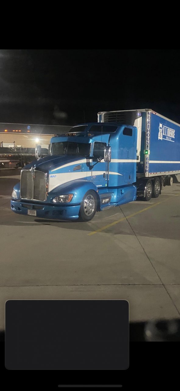

    Can someone pls input some information how to do it the right way . I did order kit from popular truck part web site and it includes everything i need for install , but after doing some measurements here and there i believe this kit is only to add air ride comfort , my goal is to lower the front end 4-5 inches ( hate the gap between the tire and fender ) , some guys suggested to run 24.5 tall tire on steer but i doubt i will get desired look . Just ordered 2 bags from rear 8 bag kw suspension as one guy did and posted video on youtube to play around . I have seen many guys with lowered trucks remove 1 of 2 leaves on the front - how safe it is ? Also would like to install probably leveling valve ( similar like for drive air bags ) .
    I appreciate any information , trying to build the kit or modify existing one to my specs .
    I know another option is pete car hauler axle ...dont realy want to go that route , i think it will be more expensive ...maybe not

    This is for kw t660 2010

    Perfectly safe removing leafs. The main leafs will keep the alignment and allow the bag to Cary the weight. You can remove the spacer (block) that’s under the axle as well. Double check the axle to oil pan clearance.

    Some Front axels can have a 3.5 drop or a 5.5 drop
    5.5 drop with air ride , looks great .
    that's buying a new front axel. Though.

    That is the goal

    Not sure if you do Facebook but hit up Sweet Ride Logistics out of Haugan Montana. They have most of their trucks including a couple 660’s on their air ride steer kits.
