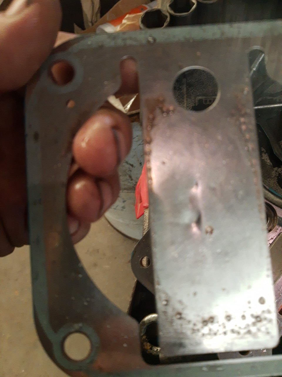

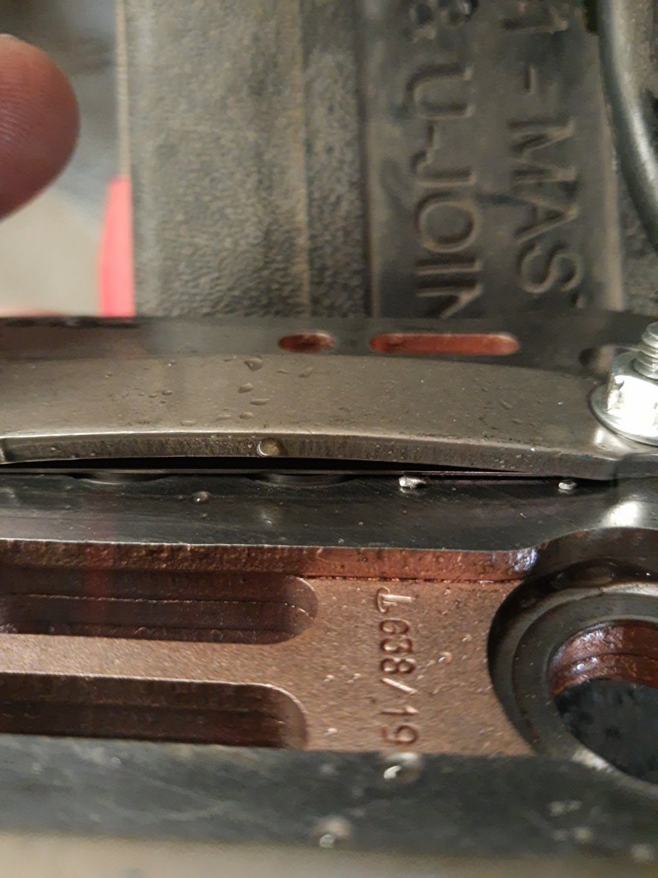

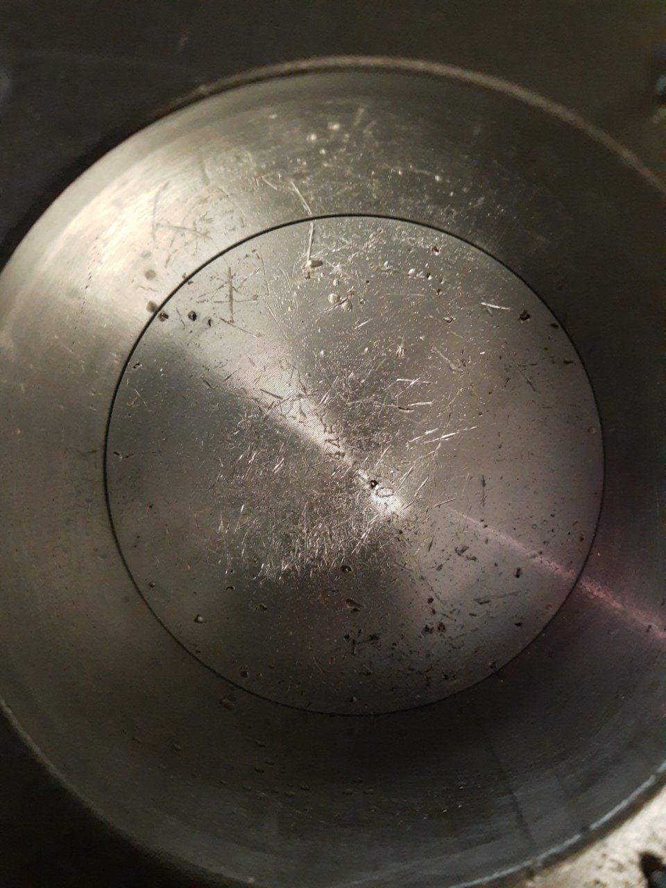

    We had a previous one at the shop and found traces of metal shaving eating up the piston. Have pics below

    That’s probably a detail/clue you should have mentioned in your original post. Any other details/clues that that may help someone trying to help you? Since the shavings shown are on top, check your inlet all the way back through the turbo.

    Mar 31, 2020
    I just found that out. Talked to bendix and they said it could be coming from the compression box that is connected to the inlet tube
