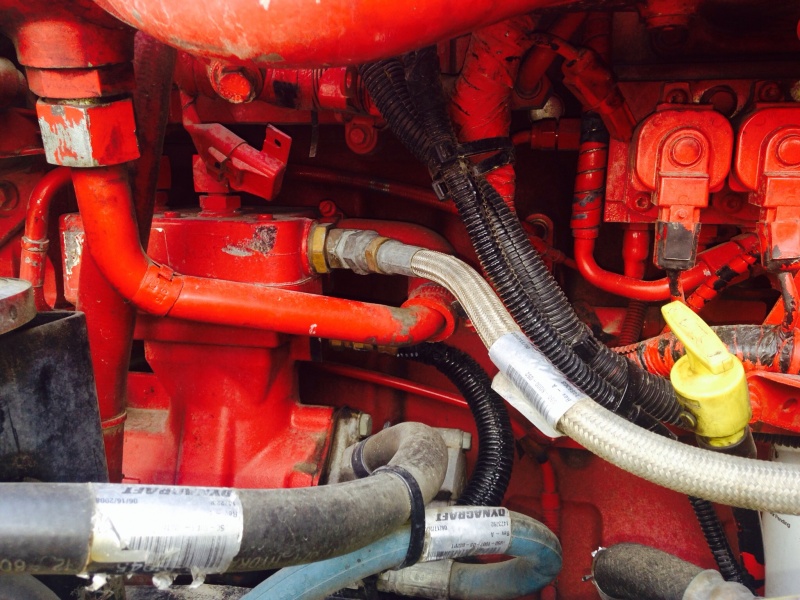

    image.jpg Tried to upload. It's the air compressor, stock with ISX CM871, with the flat top. I'll have to open my computer maybe it'll let me upload.

    I don't think it uses the D2, I am thinking that you need to contact Cummins or at lease get the part number and cross it to a bendix number. I drive a few trucks with the same engine and I've never seen a d2 on any of those, however I know that they replaced on one of them the air dryer unit at one time.

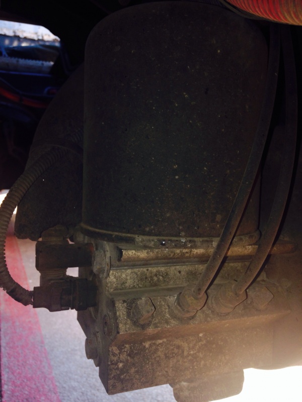

    The governor is mounted on the air dryer on the newer Petes. My air dryer is mounted underneath between the fuel tanks, but yours could be anywhere. It should look something like this.....

    That was the picture I needed SL3406, I was looking in all the wrong places. Looks like mine even has a D-2 on it. I will deliver this load tomorrow first then work on it at home tomorrow. I wonder which one is the discharge valve davidLee? Is that the purge, or where it purges out at?
