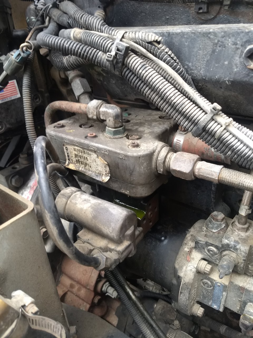

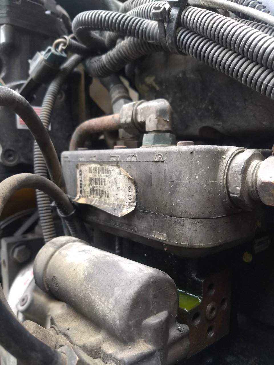

    IMG_20210706_124402_02.jpg IMG_20210706_124401_02.jpg IMG_20210706_124402_01.jpg IMG_20210706_124401_01.jpg I have a 1999 Freightliner with an N14. The air compressor is seeping coolant between the coolant head and the Head of the compressor.
    Air compressor cummins number is 4318214 rx.
    Gasket kit 4089238
    Gasket kit with head 4089207
    The type of compressor on my other truck is much cheaper. I would just replace the whole unit.
    This compressor has a higher cost and the availability is limited. Most places have to order from cummins.
    I can order online but it takes longer. I want to be back on the road Friday.
    I can't find a drawing of what is inside this compressor. I wonder if I can just replace the top piece and gasket between it and the compressor head. Is there a few parts inside? Just the gasket? Or should I replace the head and the coolant plate?

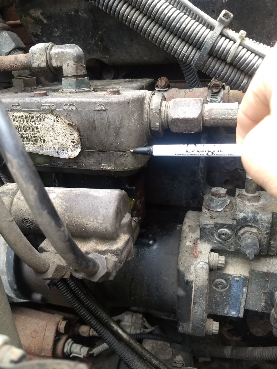

    The coolant is seeping from the gasket where the pen points.
    Thanks for answers.

    Did you look on Quickserve? There should be a schematic
    If not, Cummins should be able to print out a schematic and parts list for it, they did for mine anyway
    There are a few kits for them. I'm not familiar with that model but there should be a top end kit with all the gaskets and seals

    Yes I looked in Quick serve. They don't show a schematic for the inside of the compressor.
    I'm changing the whole unit. Might as well bite the bullet and do it once instead of a couple times.

    Probably just the gasket. If head and body are flat and not erroded replacing the compressor head gasket would probably fix it.
    Rideandrepair and xsetra Thank this.

    Probably not what you want to hear... But I recommend you replace the compressor. Run it if you are able to and keep an eye on the coolant. Because the head could be cracked or warped. Head gaskets are always more that just replacing the gasket.

    I'm replacing whole unit. Because "it's a new to me truck". Less than 10,000 miles. Total miles just under 1m.
    If you look at center Allen head bolt. It broke in the body. You can see the threaded shaft coming out the bottom of head, behind the governor.
