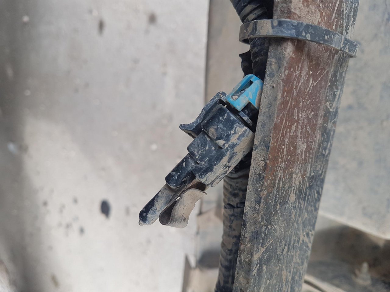

    Heavyd said to remove that wire before I blow the system but at 108 degrees in Fontana CA it's hard to follow that recommendation. I got nice cool air most of the day, but in the afteenoon it wasn't blowing cold anymore and the lines were frozen so I removed the wire. Tomorrow I will disconnect the batteries and see what happens. I will look for the ambient sensor but again the computer shows no alarms everything checks ok. ??. 20180809_202241.jpg 20180809_202241.jpg 20180809_202241.jpg

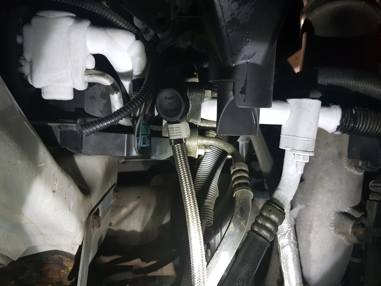

    Those are the thermistors. They are located on the passenger side, about eye level, one is on each line by the dryer cartridge. They have two wires to each sensor. The system needs to be evacuated to replace. They can be tested with a multimeter. They control the signal to the cab controller, they read the line temps. They used to go bad quite often, but they were redesigned and in my experience now rarely ever fail.

    That is not good, and HeavyD is correct, that looks like failure time, you cannot run the compressor like that. Get the truck to a dealer and let them diagnose. You need Diamond Logic on there to diagnose exactly what is going on.
    These AC systems on these ProStars are ran through the cab controller and a thousand other can bus modules. This is not your old school AC systems. Sometimes the dealer is the best place to start, God knows I have had to go there more times than I would have liked to, as I do not have a copy of Diamond Logic. Sometimes it is the only way to properly diagnose.
    Do that first. One other thing I did to get my system working, blowing cold, is to remove any die from the AC system. I run straight refrigerant. That and moving that Ambient Air Temp sensor and I have had no issues with the system. It now works. Your system holds 3 lbs of refrigerant, if you have a sleeper with its own AC system, and is very finicky about that too. It can be a little light, but go over that 3 lbs and trouble awaits.

    Your truck is a 2010+ model. It no longer uses thermistors. If your guy is using Diamond Logic builder software, these are the interlocks that must be met for the body controller to turn on ac compressor;
    • Ignition and Accessory voltage at body controller (Checkmarks at A1 and A16 at 1602 of B/C)
    • Air conditioning request from HVAC control head to B/C (Checkmark at 1600_A2)
    • Engine running signal (Engine_Running)
    • Engine speed above 300 RPM (Engine_Speed)
    • Low pressure input is grounded (Checkmark at 1600_B5)
    • Freeze Probe Thermistor input is ≥ 38° F ( HVAC_Freeze_Protect_Raw above 2.4976 volts 1600_B13)
    • A/C high side pressure is greater that 35 psi, but less then 218 psi (AC_High_Side_PSI) - Pressures may change due to programmable parameters. See table below.
    • No HVAC fault codes active
