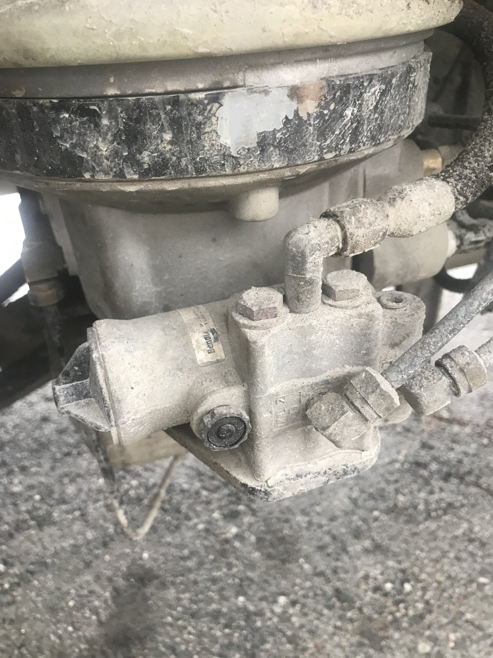

    I have replaced the governor and it’s mounted right next to the air dryer. I don’t have an actual picture of the whole dryer but this is what it’s like. There’s one picture of my actual governor and the other two are pictures I took of the internet. The one that has the circle in is where the spring is, it goes over top the purge.

    For starters it may be easy to switch the unload and resevoir air lines on the governor. Double check air lines and trace out unloader and resevoir are correct. Check both lines for restrictions, kinks or leaks. Other option to install gauges and see what pressure you have where and when to determine whats going on.
    Bendix techhelp can be very helpful if your stuck
    Call them 1800AIRBRAKE
