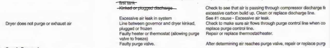

    What model dryer do you have?
    This for AD-9si
    6. Air dryer does not purge or exhaust air. A. Faulty air dryer purge valve. A. After determining that air reaches the purge valve piston–by installing a Tee fitting with a pressure gauge into the control port –repair the purge valve if necessary. B. See Causes B, E, and F for Symptom #4. B. Refer to Symptom 4, Remedies B, E, and F
    4. Constant exhaust of air at air dryer purge valve exhaust or unable to build system pressure. (Charge mode.) A. Air dryer purge valve leaking excessively. A. With the compressor loaded, apply a soap solution on the purge valve exhaust, to test for excessive leakage. Repair or replace the purge valve as necessary. B. Purge valve frozen open - faulty heater and thermostat, wiring, blown fuse. B. Refer to paragraph 5 of the Operation and Leakage Tests for the heater and thermostat test. C. Defective AD-9si air dryer delivery check valve. C. Refer to Symptom 1, Remedy B. D. Leaking turbo cut-off valve. D. Repair or replace the purge valve assembly. E. Defective governor. E. Check the governor at both “cut-in” and “cut-out” positions for proper pressures and excessive leakage at the exhaust. F. Leaking purge valve control piston seals. F. Repair or replace the purge valve assembly

    Wabco air dryer troubleshooting (alltroubleshooting.net)
    Air flows out of purge valve entire time compressor is unloaded. Turbo cut-off valve not sealing. Outlet check valve not seating. Yes Yes Replace turbo cut-off valve. Replace outlet check valve.
    The link also covers this.
    Air dryer does not purge when compressor unloads (no blast of air from purge valve).
    What model Wabco do you have?
