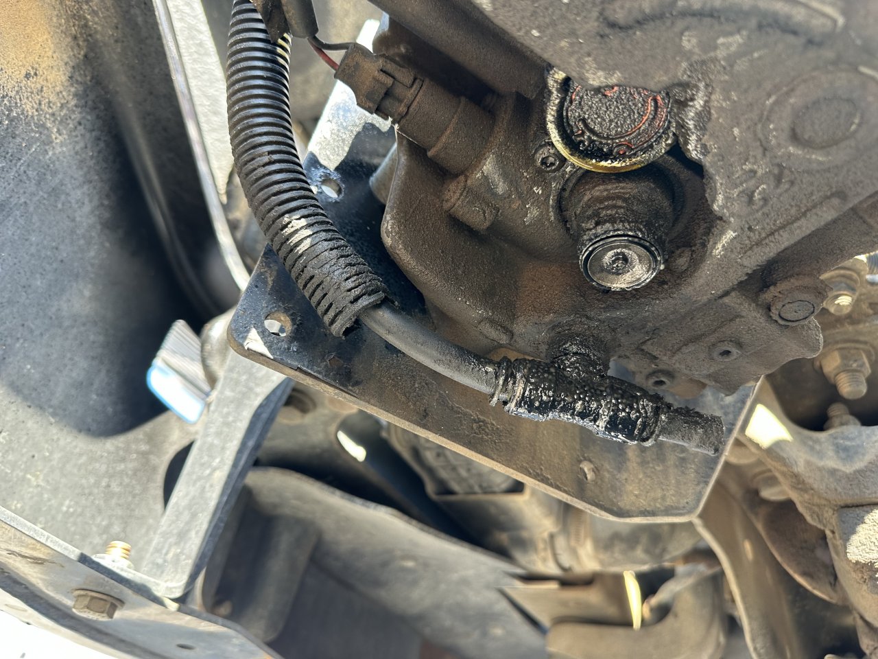

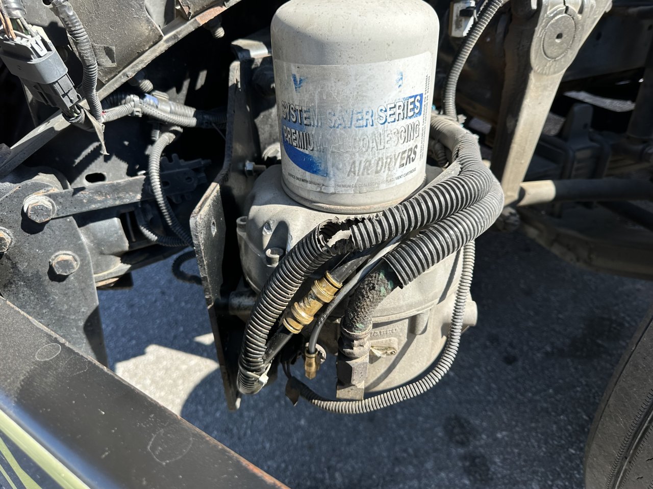

    Pulled the signal line off the dryer and it’s popping off at 160 so I’m assuming governor is bad as it should be popping off at correct pressure.
    Also it’s blowing some oil out of the signal line and underneath from blow hole. Would this be a bad dryer filter?
    I plan to change both….cause I’ve not put a new filter on it since I’ve owned it. IMG_0660.jpeg IMG_0659.jpeg

    That oil is most likely coming from your compressor…..
