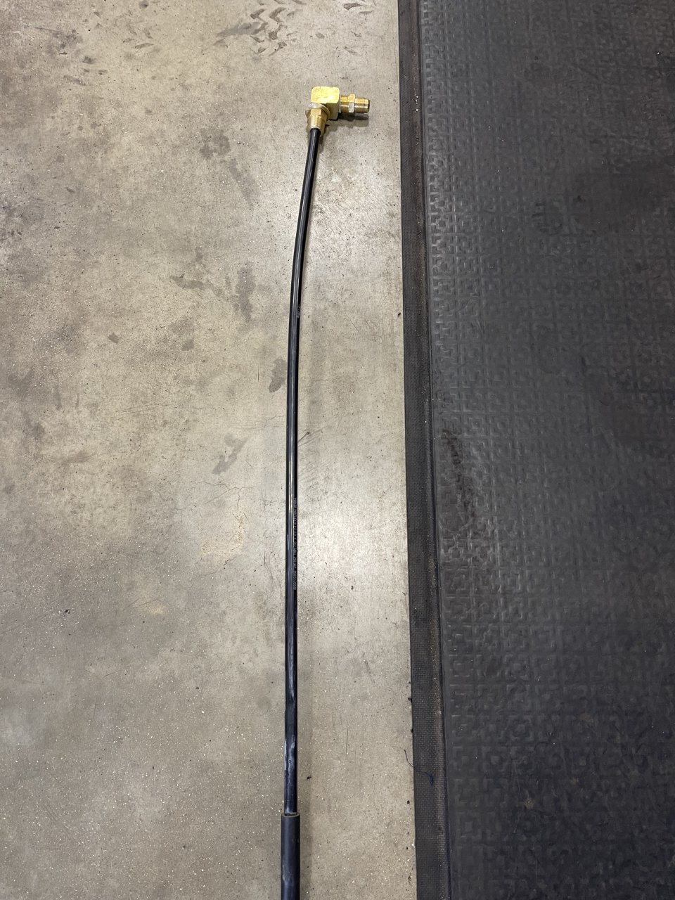

    Paccar part# V88-1003.
    These go in the suction pipes- You will need 2 so they match for leveling.

    How long are these? Do you know? Im having precious little luck finding that information. And if long, i assume you can just trim to fit?

    Hallelujah! I’m having the same issue and was thinking of building something like these. I just ordered 2. I’ve been using the ball valves that I installed at the top of the tank to keep my left from running dry while I have 1/2 full right. Lately I’ve just shut the left tank completely off until my right hits 1/2 then turn back on for a 100 miles or so until the left fills the right to 3/4 then turn off left until I get fuel.
    2014 389 150 gallon right-110(IIRC)left

    OAL is 36” from top of fitting to rubber tip. Yes it is trimable.

    Bueno, ordering 4 (with drivers pickup damaged, since i just left my reyurn long, my temp fix has just been to swap draw and return)
