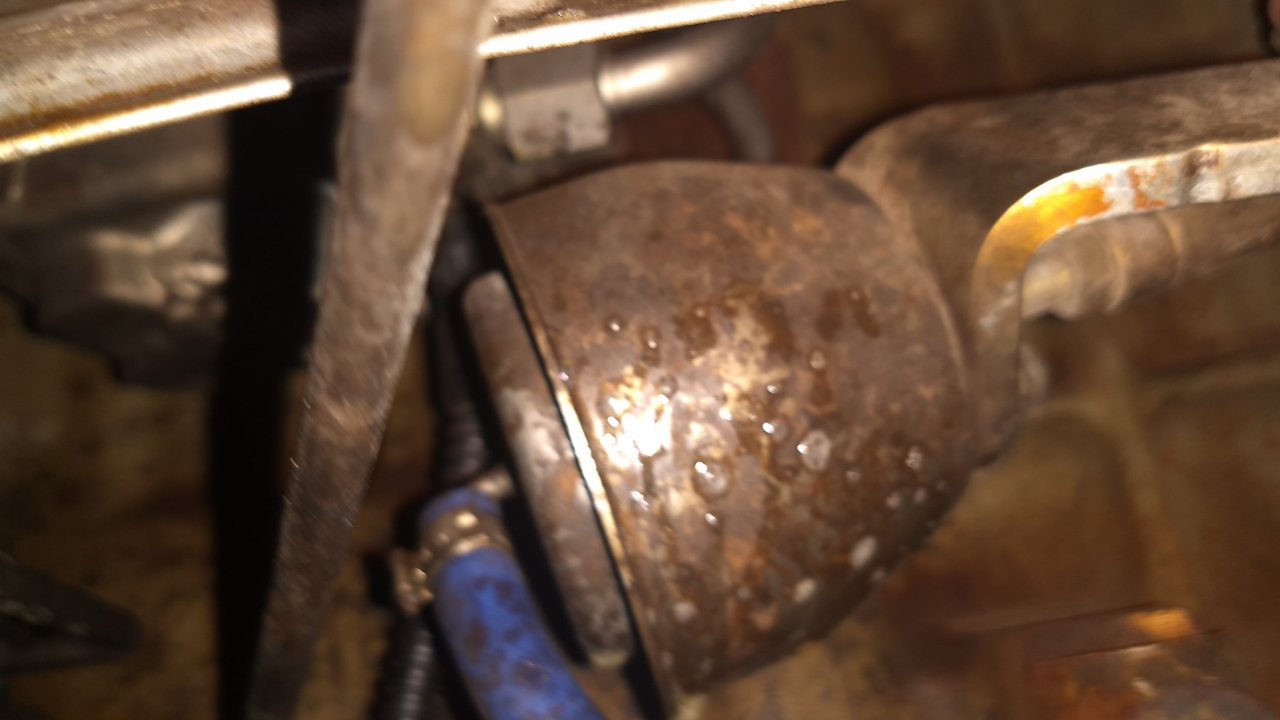

    Based on that blue high-temp line, yes, turbo actuator. Can't tell from your other pic what it's connected to.

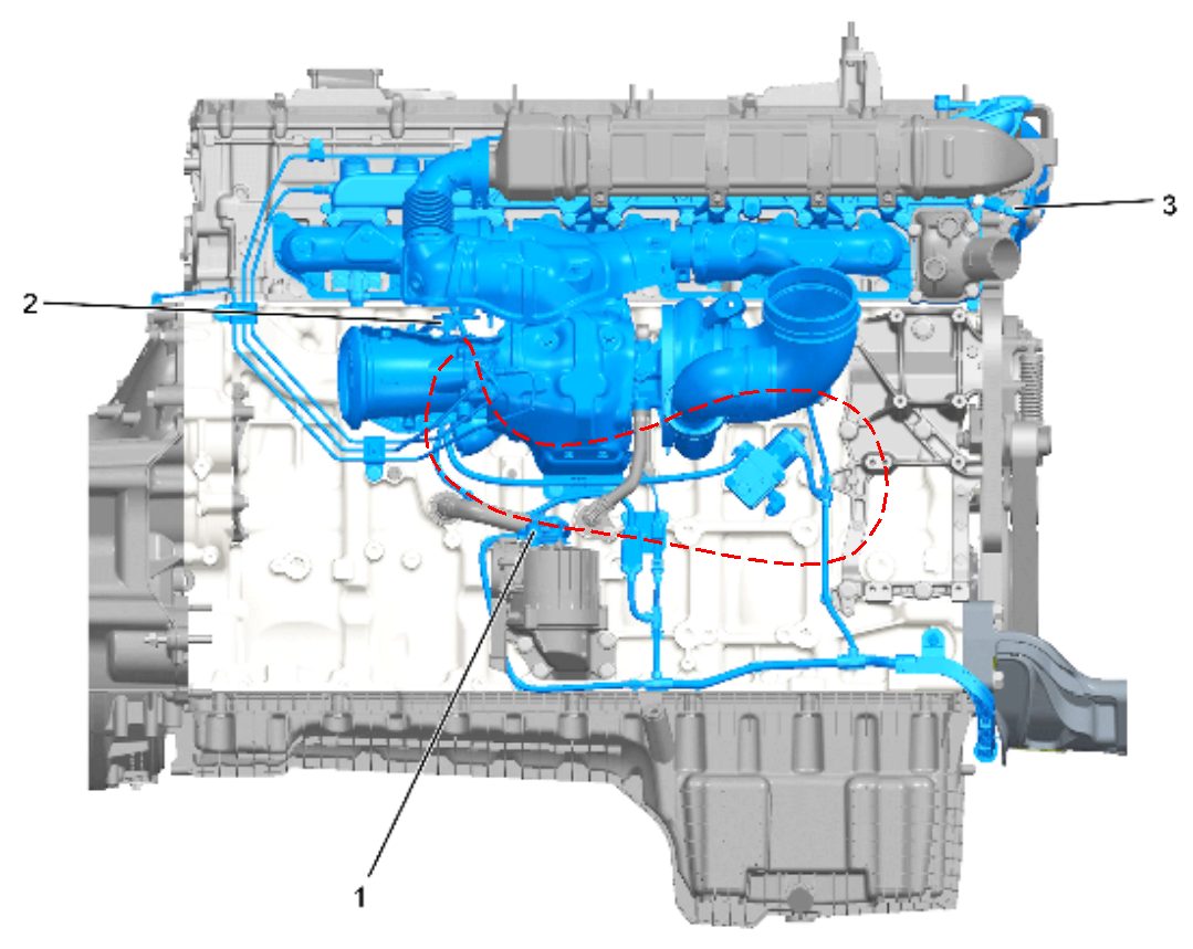

    here is a picture maybe this will make more sense

    The back hose that on the top picture is connected to the block

    Bad diaphragm on actuator. Suck or blow on hose, you'll know for sure.

    Sorry not sure what suck or blow on hose

    The blue one. Or put low air pressure on it.

    No leak on the blue hose so from what I understood take the blue hose off from air control valve and apply air to it and see if it leaking
