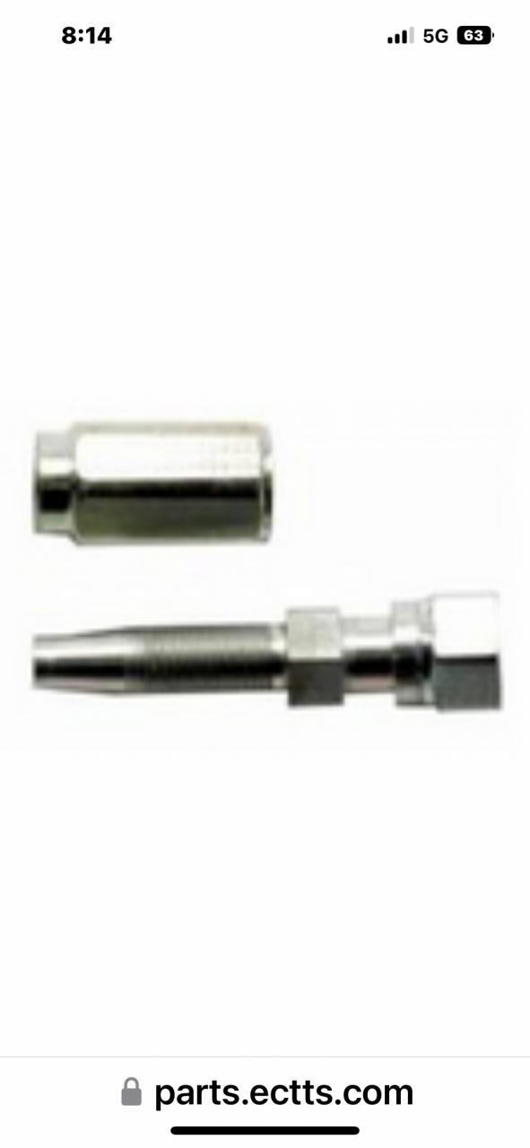

    A90D2F7A-F46D-4E55-8FA0-CFD8F32D749A.png A90D2F7A-F46D-4E55-8FA0-CFD8F32D749A.png Get some of these to use with bulk hose.
    D.Tibbitt Thanks this.
