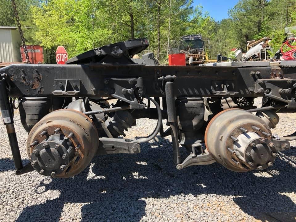

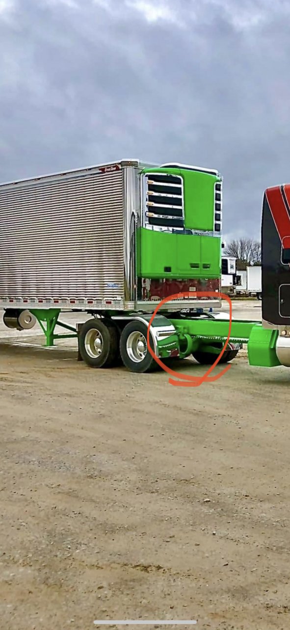

    I’d definitely reconsider. The AirGlide 380 is the KW version of the Pete FlexAir, which is the best rear suspension I’ve ever ridden in front of. When you’re driving down the road and you see a KW or Pete coming around you, pay attention to the rear suspension as it goes by and watch how it reacts over bumps and bridges. You’ll know it’s the one I’m talking about, because it has a big loop sticking out forward of the axle and is easily seen in front of the drive tires. The brilliance of this design is the axles can move fore/aft a certain amount, which eliminates the harshness of hitting bumps. To me, it feels like riding on a huge block of rubber, as opposed to a rigidly mounted suspension. See if your dealer has something on the lot with the AirGlide 380 and tell them you want to hook it to a loaded trailer for a test drive.

    Looks so fragile though.

    Yes I’m going with the 380 I talked to a buddy of mine today and he has about 300 trucks and he said by far the least problems is with the 380 or his Pete flex air, he said seems like all the airbags are pieces of sh#t not lasting long but that’s not the suspensions fault it’s just the manufacturers on bags are not making them like they used to. But he did tell me he has had good luck with the front a/r suspension too, said if I wasn’t used to it would take a little getting used to at first but ride is a lot better.
