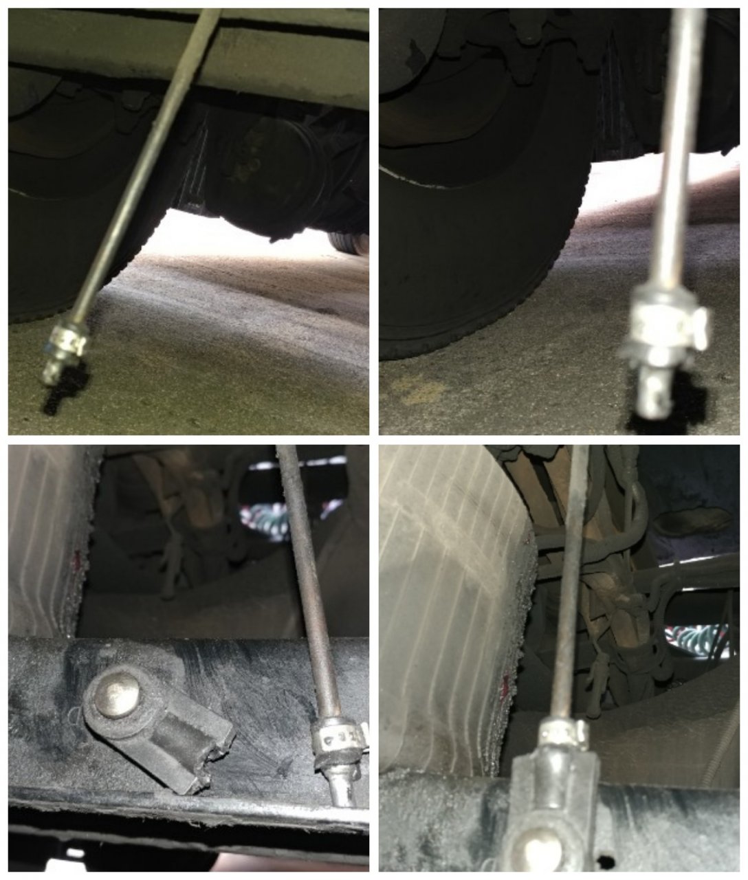

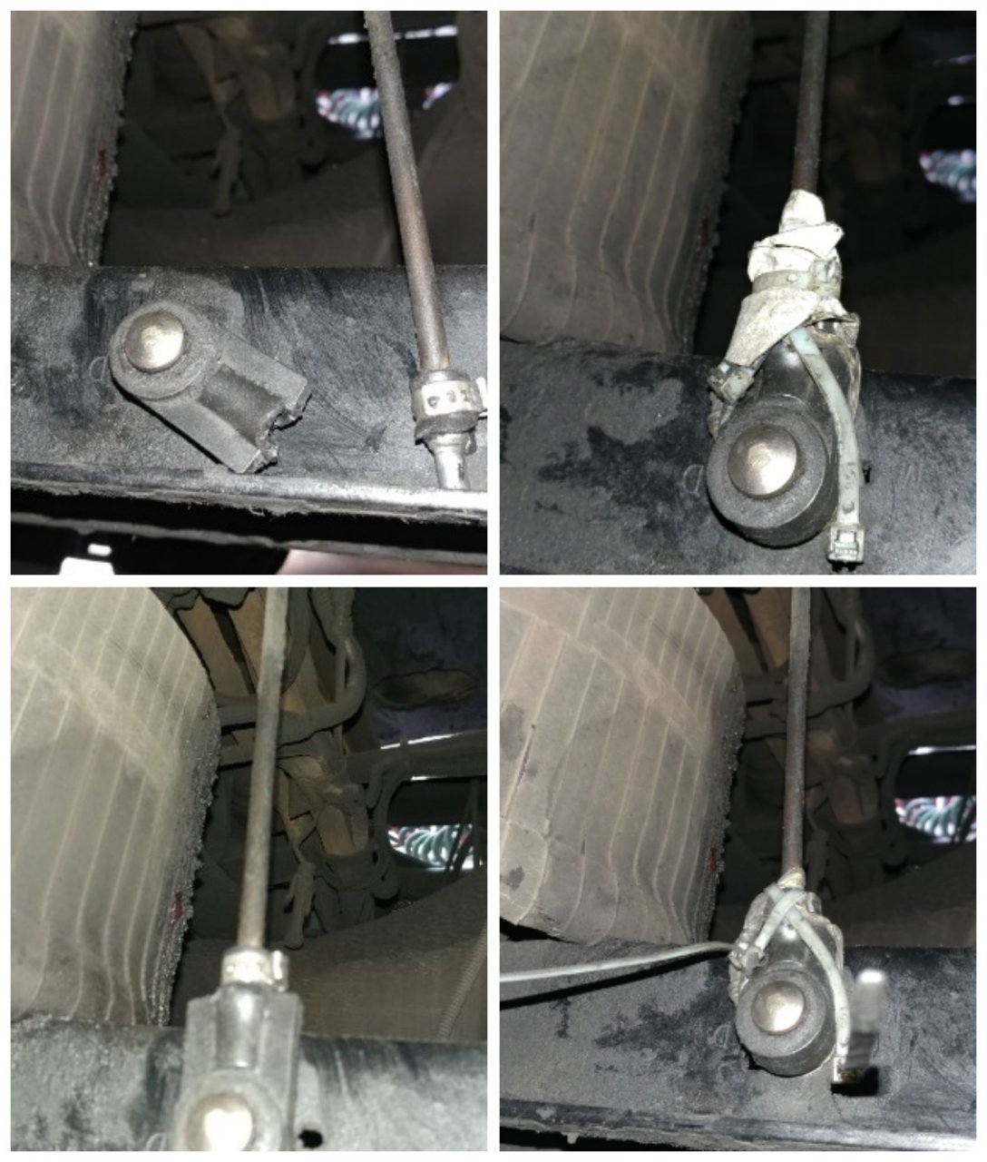

https://m.ebay.com/itm/VOLVO-VN-SUSPENSION-LEVEL-CONTROL-ROD-20571129-22379948-85141824-20395935/281611047167?ssPageName=STRK:MEBIDX:IT&_trksid=p2060353.m1438.l2649
Here's the part you need for $18 with free shipping.
The Volvo Stealership is charging $38 plus tax.
I'm going to buy one for a spare because the ends are made out of rubber and with the heat and time the rubber cracks and the part fails, and it will fail when you're out in the middle of nowhere too.
For $18 you can get two for the price of one at the Stealership.Last edited: Sep 24, 2017
