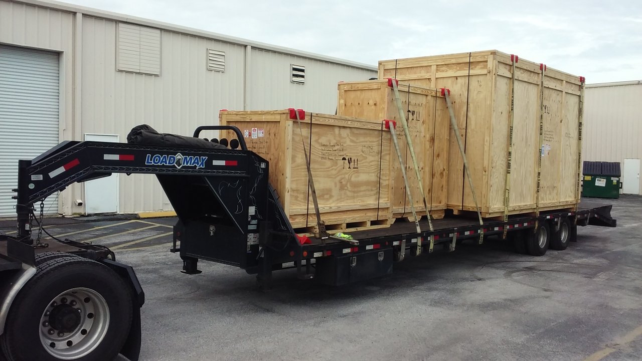

    I took this air ride only load, partially by accident. Paperwork said ~$675,000 gold immersion machine. Took it from St. Pete, to Miami, FL. Bound for Malaysia, expedited to DHL air freight. Magically no one mentioned the word air ride till it was strapped down, with ~5 hours till plane departure. Shipper: "Hey, that trailer air ride, right.?" Ahhhhhh, yep, you bet. My hesitation caused a funny look, but he never got down & crawled under to look..
    My truck was air ride rear at this point, but still a leaf sprung hotshot. Luckily FL has about the best roads in the country. That's the only thing good about this pecker shaped state. I took a gamble. Sometimes the stars align & you win..

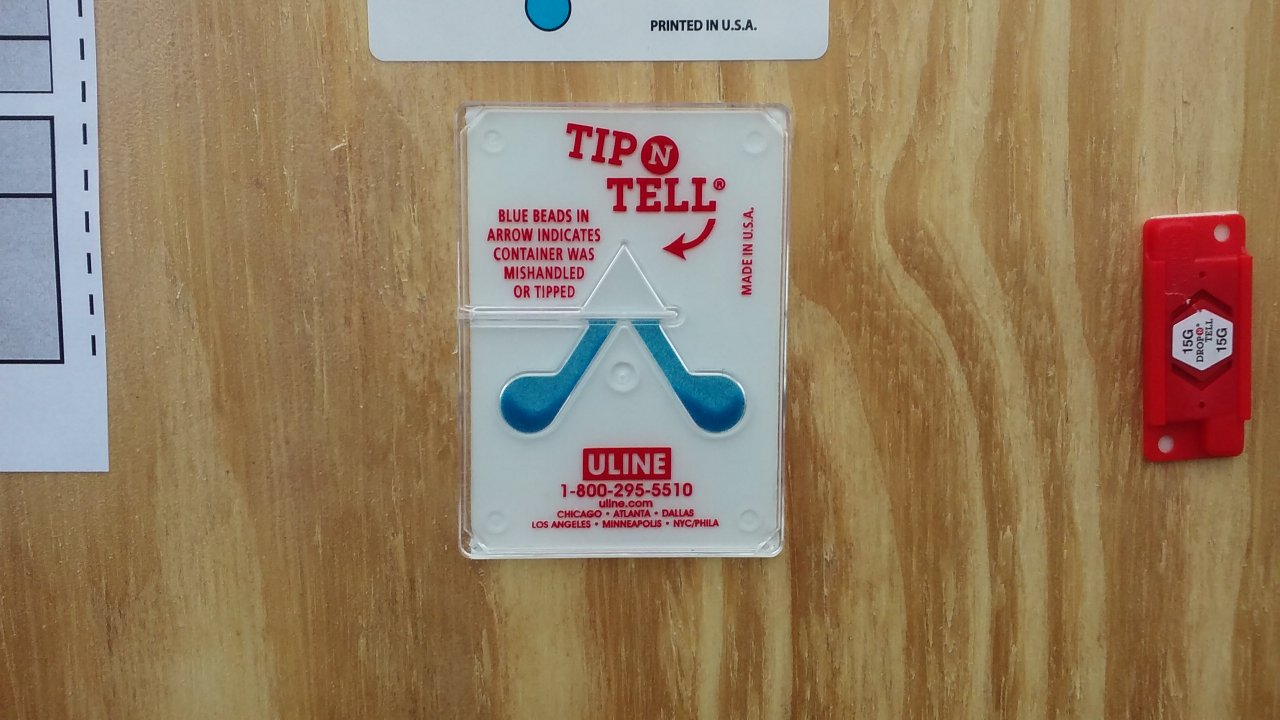

    They put these little tattle tales on the crates too make sure it wasn't shook too bad. I got pickup & drop pics to cover my ace. Probably wouldn't do it again, but now I don't worry cause I'm air everywhere..

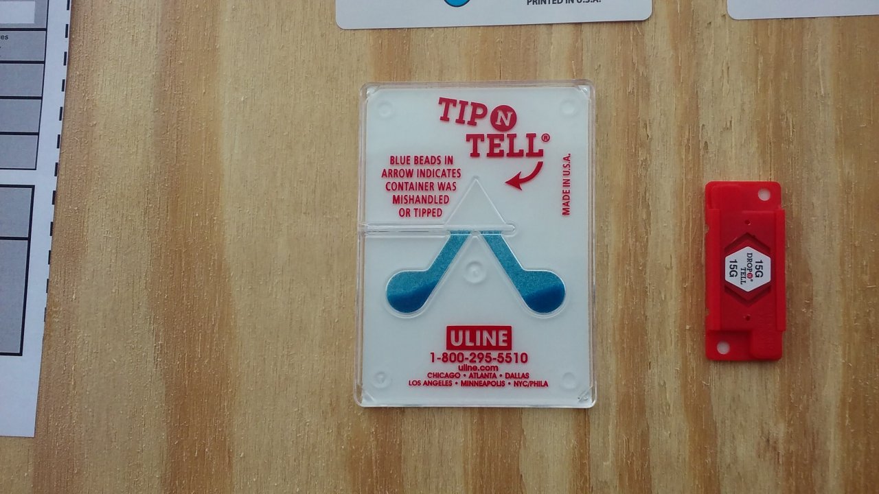

    I have never seen one of those Tipp N Tell signs before. So simple but pretty slick.

    Wow, really? Every piece of equipment I ever shipped had them. We also put them INSIDE When shipping overseas, because, they mysteriously disappear from the crates. If they were missing, we didn't sign off and release the transporter until they could be verified.

    Funny you mentioned inside the crate.!
    I distinctly remember the boss scolding one of his lackeys about them being on the outside. They took the tops off all 3 to attach 2 inside of each box. Slowing the load down even more.
    It's a bit over a 3hour drive to the Miami DHL terminal from St. Pete. The second I rolled in they had a fork lift & highboy trailer along side me. Transferred off mine onto their's, took pick to CMA, & off to the cargo plane it went. Luckily for them there must have been no low clearance on the 2 mile trip, cause the big box must have stood 15'5" tall on their highboy.. LoL

    Used to get sensitive shipments in crates with ball and spring accelerometers for two axis's on them, if the ball did fall, you refused the shipment.
