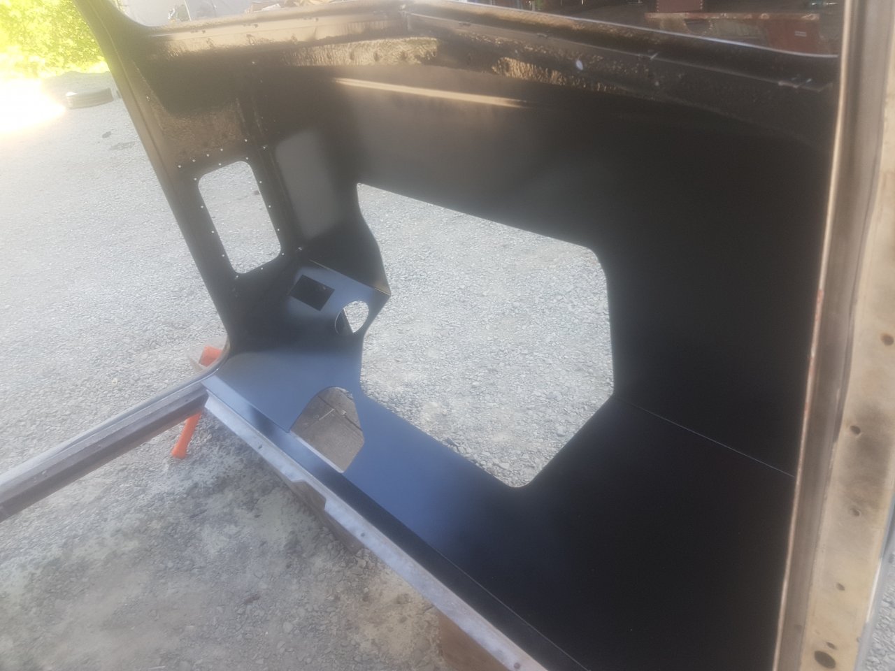

    The cab on that old blue W900 is more steel than aluminum. Probably why its lasted so long.
