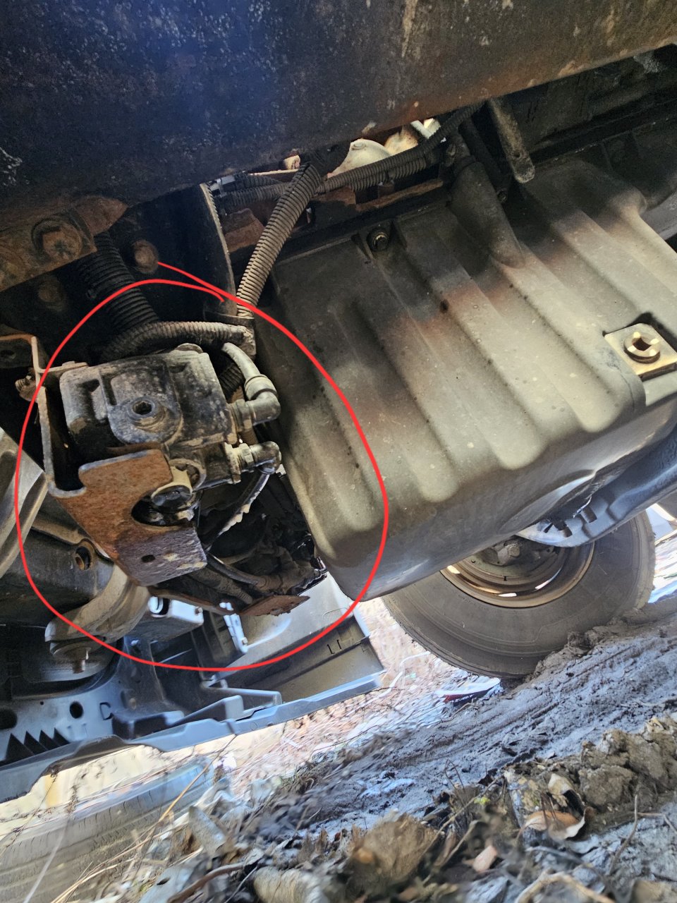

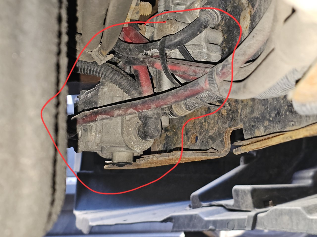

    what's this air system assembly under the front bumper?

    QRN valve for front axle brake chambers?

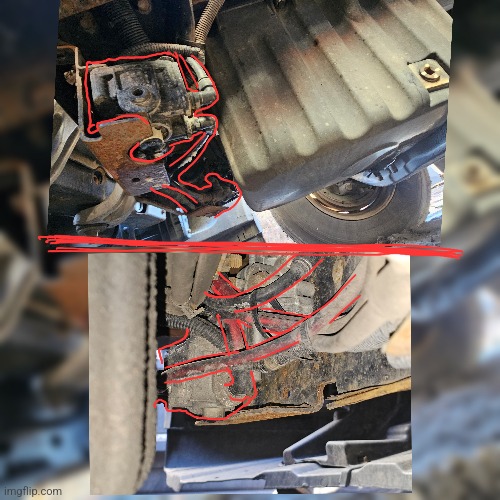

    Probably a quick release (QR) valve for the front brakes. Follow the lines and see if they go to the front chambers. Can't tell much from the pic even though I saved and enlarged it.

    yes! replaced the whole (original 7 year old) dryer assembly and both tanks fill now. truck still won't hold air overnight tho, depending on ambient temp it might be at 60psi or it might be 0psi.
    I know one leak is coming off of primary tanks thru a big green output line, another 7 year old quick connect that's served its time, it's only loud if it's ~35f ambient. just found this other audible one from up front under the bumper but the only soap spray bottle i have is a mister, can't get a squirt close enough right now to make any bubbles.
    here's the originals not ran through meme generator

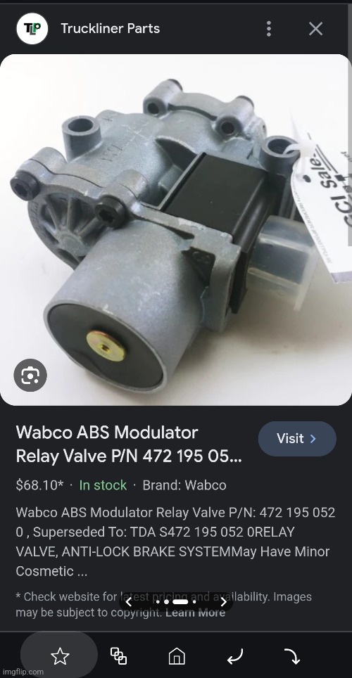

    front ABS modulator valve? it's got that black round flap on the bottom distended part
    youtube hive mind say check valves in brake chambers go bad too and leak through ABS valve purge...
    utube hive mind also say air leak location is most likely not the actual problem...

    front ABS modulator valve? If it has both air lines and wiring going into it, then yes. Pics are better but hard to tell if any of those harnesses are connected to the valve.
