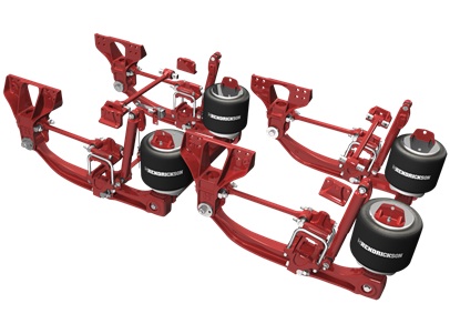

    Looks like Neway- that's Hendrickson?
    What I'm looking at already has Air Trac...which, although/because I don't know much about it, isn't my first choice.
  5. Cat sdp
    Cat sdp . .
    21,309
    76,242
    Apr 8, 2012
    Orion's Belt
    Yes, it's a Hendrickson clone of a Neway.....
