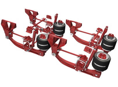

  9. pushbroom
    pushbroom Road Train Member
    1,779
    7,317
    Sep 1, 2012

    Do you have any rough idea what it costs to buy a new Primaax suspension? I'm guessing astronomical? I'm interested in just a single axle...
