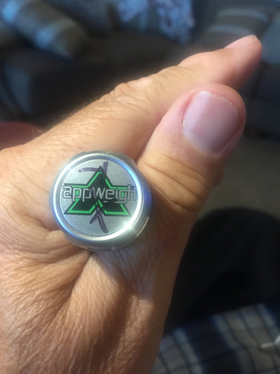

    I bought at GATS for $135 each, on line $150, AppWeigh.com or Amazon
    Tug Toy and ShooterK2 Thank this.

    4 to 5 k plus install. Does it have solid gold bezels? It can be done for less than less than $40 a unit with gauges.
    I choose to spend $270 on a wireless system so I could check weight without climbing in and out of a piece of rolling stock while adjusting weight.
