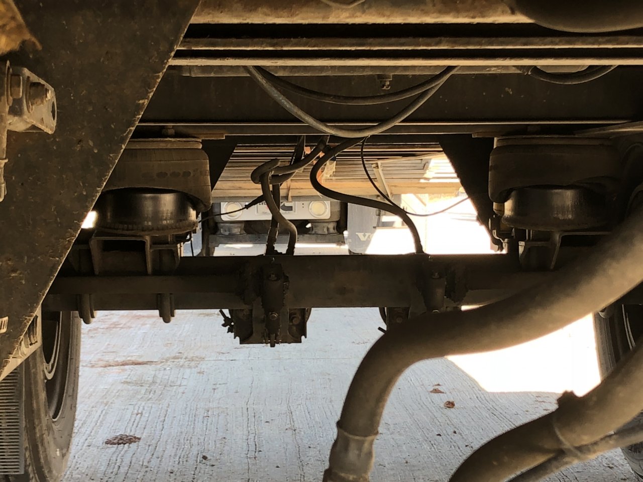

    1B35FBEB-68DB-4EF6-B0F8-9164EBA6F301.jpeg had to make a downhill off road delivery today. After looking over the truck I noticed my front axle trailer airbags don’t look seated right anymore. This isn’t normal right?
    I’ve let all the air out the tanks back there & the bags and I’m trying to pry the bag back over. It wasn’t leaking air but appeared to be pinched in such a way that a good bump would pop it

    NEVERMIND! I was able to get it. Had to let the air out the tanks, then crack a line loose to the bags, let it all drain, then I guess with trailer trailer completely flat on all four bags, it leveled itself back out once the new air got delivered.

    Bag foldage. Nice!!
    Usually cured by overinflation. Or just drive and they will cure themselves .

    What swaan said.
    That happens to me once in a while on the rear spread. I just pull the pin that attaches the leveling valve and raise the lever to let air in till the bag unfolds.
    I always feared if I just drove it till it fixed itself I would potentially pinch or damage the bag.

    I second that you could have just taken the leveling valve lever loose and over inflated the bags

    Yeah in hindsight that would of been the simpler fix.

    That's a trick that will come in handy on the truck for a few different things. Main being a trailer that is sitting to high

    Had a lift axle that done that not no more problems solved by restricting the exhaust port let air out slower maintains pressure in side of the bags as billow. s. Lift

    Empty, no weight of a load..right? Well loaded would probably work too, just would snap more when it straightened out.
