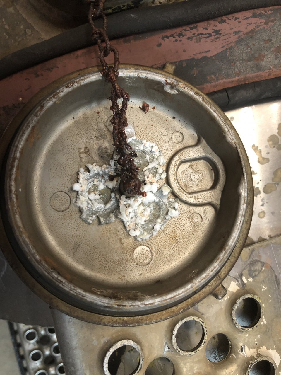

    This is what the watered down new diesel does. Never had a corrosion or slime problem before the new B10 stuff came out and diesel became “synthetic” so to speak. Granted this truck here only gets fueled once every 4-6 months, but it is 48 years old and had no corrosion in it until recently. I also started to see the black staining happening within the last few years inside the tanks of my ‘67 Pete with the b10. Those tanks have always been shiny clean and you could see to the bottom of them. image.jpg 0E8798FE-0F92-4844-8132-D9E902442979.jpeg

    Yeah, thats polymerization from fuels with a percentage of organic base stock. Notice it turned the bare mild steel chain black and rusty but only condensated and hardened up on the aluminum cap.
    Unfortunately there isnt much you can do if all your available fuel is a govt mandated blend.
    A5¢ Thanks this.

    I think humidity and temp has a lot to do with it. Down here when its hot its wet and sticky and when its cold its wet. Not much dry air all year round. Always something blowing in from the Gulf to get the humidity high. Guess it is prime conditions for the growth. 3 of my trucks sit in an insulated shop. The fuel caps in the pic are from one of them. The tanks will still have condensation on them sometimes if the humidity is above 85-90% outside even in a closed up shop.
