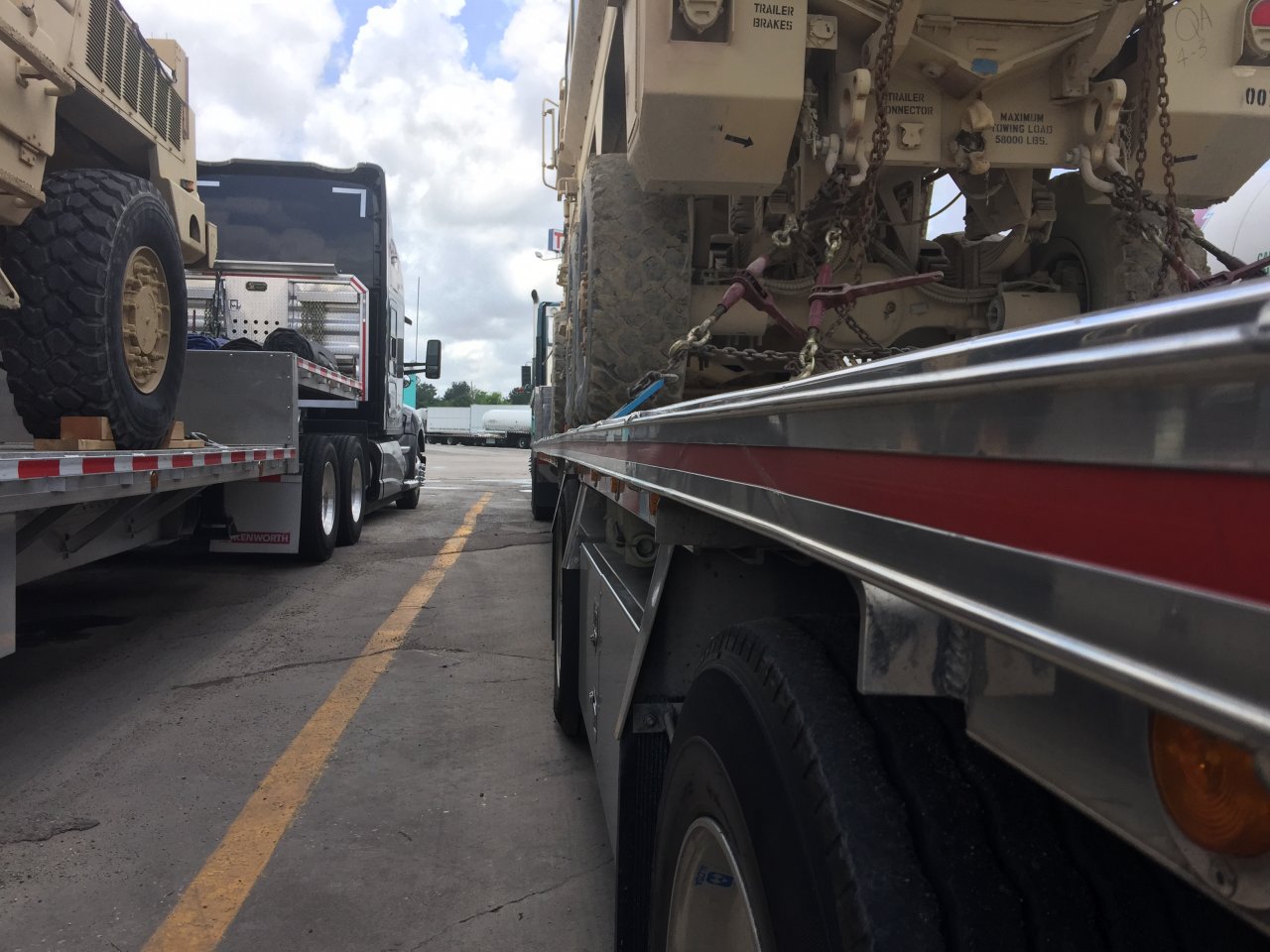

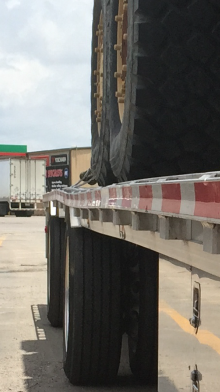

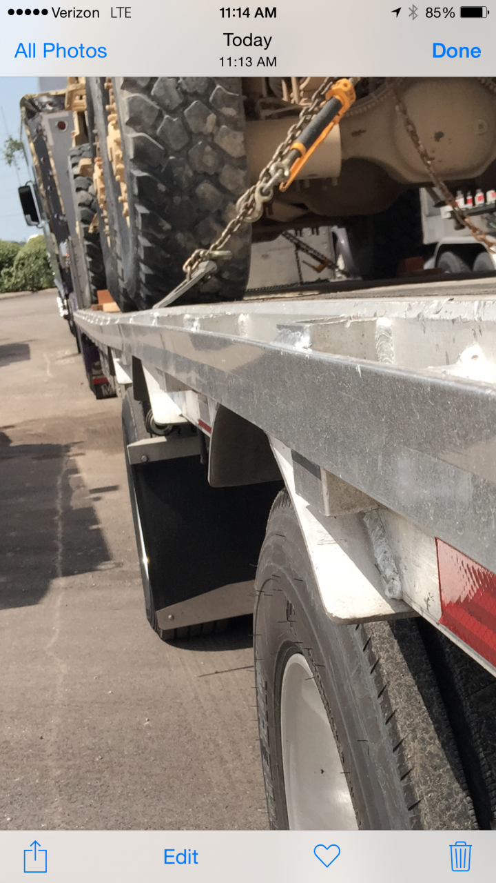

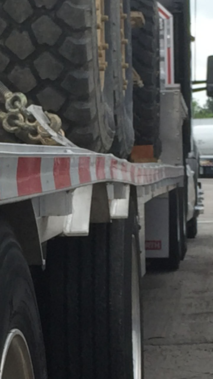

    View attachment 134086 Here is my Mac with no supports from the frame to the rub rail & 53,000#'s of truck on it. The pics are of a Reitnouer and a Chaparral. The Reitnouer and Chaparral both have the supports from the frame to rub rail.

    I didn't think anyone made a deck without knee braces. That's crazy. We have Lode King, reitnouer and Wilson. All have them.

    Mac will, when I ordered this trailer I had seen other Macs with out the braces & told my rep I liked the clean look with out them, he told me that's no prob they can build it with out them- not sure what they do to get around it but I seem to think they have it figured out.

    Those pictures are impressive. Really shows what's what

    I've always thought highly of Mac, the pictures @Fast1 put up are pretty powerful examples.

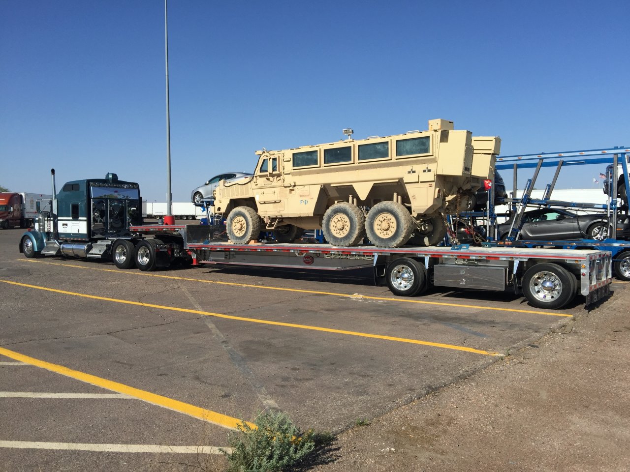

    I could not tell the make of trailers in the photos . I thought the mac had the bow ....
