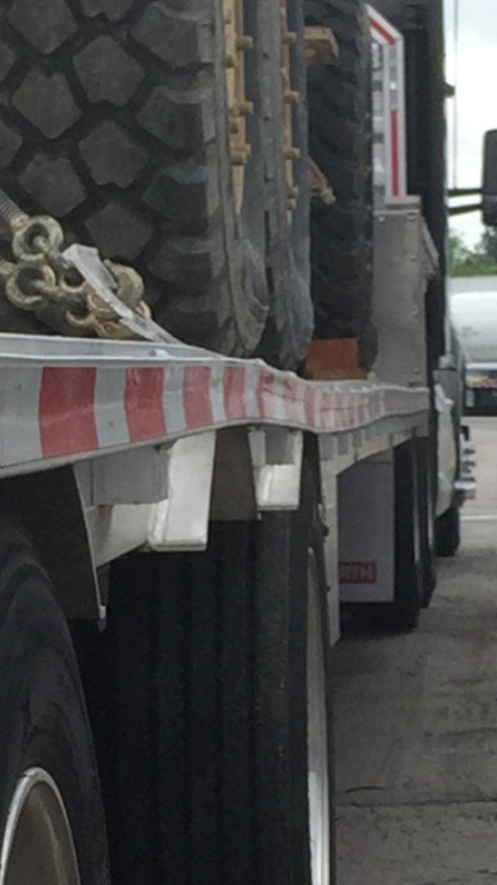

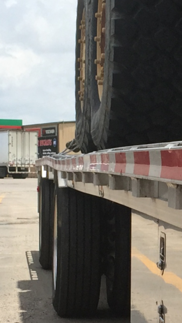

    The Mac is the one with no bow, with the solid red stripe down the side.

    Ok , what trailer is this ? I know it's not good.
    And the mac without the side braces isn't bowing like this one is ...
    Mac good/ this one not so much :)

    I believe that's the reitnour there

    Your right Ruthless- that's the reitnour and the Chaparral is the rub rail with no tape at all.

    LOL, I made the same guess because of 2 things. number 1 is the stake pockets, they are not welded to the side rail. Number 2 is because the braces on the Reitnouer are free floating and not a solid piece they would allow you to lift on the sides that much.

    I always thought that the Reitnouer was a good trailer but after seeing these photos I would not purchase one. Maybe you could use one as a deck or boat dock. WOW!
    @Fast1 what is the weight of that trailer?
    rank Thanks this.

    The weight is +- 10,000# is what it showed on spec sheet. I looked at the two other trailers after unloading and they both went right back to where they were to start with, we hauled those trucks 2000 miles and I took these pics close to where we delivered, I would of had some sleepless nights if that was my trailer.

    I've pulled more than a few reitnour flats, even owned one. All legal weight distributed loads. They handled good for that.
    Sure wouldn't buy one to haul weight with tho #######!
