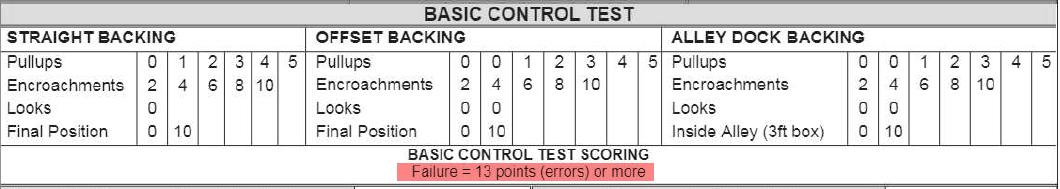

    I thought you were limited to two pull ups?
  3. jmarc77
    jmarc77 Light Load Member
    162
    428
    Sep 17, 2021
    Two free pull ups. You can lose 12 points and still pass. So if you havent used any points in the first two maneuvers, you can use your two free and then 12 additional pull ups and still pass.
