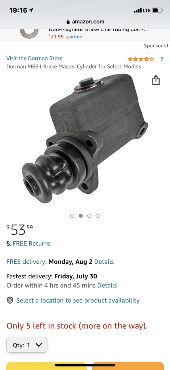

I think this is what your looking for
QUALITYTRUCK and AModelCat Thank this. -
Saw that one, it’s a 1.5 inch bore, mines the 1.75. I’ve ordered one, hoping it can be made to work.
