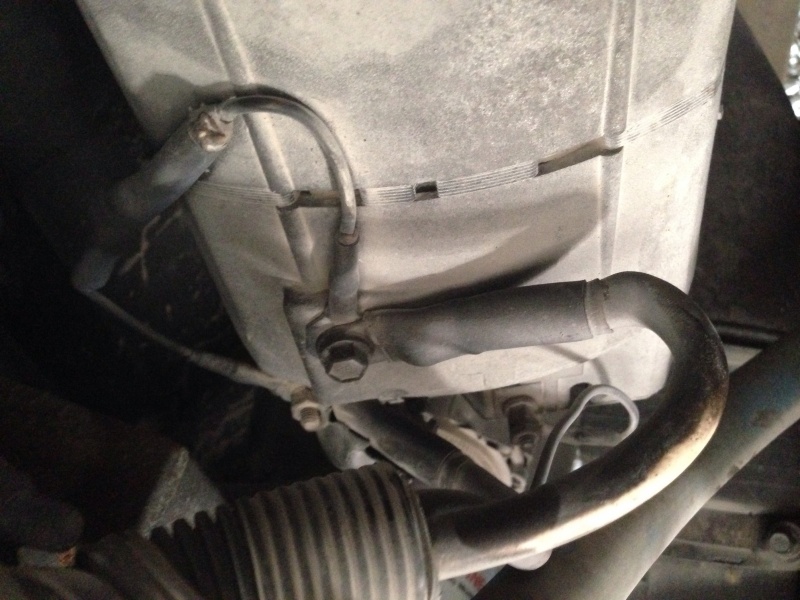

    Replaced the alternator on my 02 volvo vnm with a n14 today. There was what looked to be a fuseable link running between the hot and ground studs. Didnt see the point in it so left it off the new one. Battery light comes on in the dash but the computer reading says 13.5-14 volts as does my handheld at the alternator and battery. Any ideas on the purpose of the wire is and the light? image.jpg image.jpg

    I'm not familiar with Volvo, but could this fusable link instead be a diode?

    Possible. Just assumed it was a fuseable link.

    Why wouldn't you put it back on? If it was on originally, I'd think it probably should be on but......

    That's my thought as well, it was on there for a purpose.

    Diodes allow current to pass in only one direction.
    Again, I'm unfamiliar with Volvo. Most mechanics will always replace both alternator and regulator. Some voltage regulators are bolted on to the body, and some are inside of the alternator. Something else I'd look for is a lose or broken ground wire. Most vehicles have a thick ground to the engine and one to the frame, cab, & or firewall (classic problem causing dim headlights).

    I think that it is a capacitor, but don't quote me on that. It is not a fuseable link if it goes from the positive to negative, it would just blow if it was a fuseable link. I don't see any purpose for a diode to be there. A capacitor to surpress noise from the alternator is the only thing that makes sense to me right now.

    GrapeApe's suggestion of a noise suppression capacitor makes the most sense. The truck battery acts like a capacitor but doesn't filter (smooth) high frequency noise. A capacitor connected in parallel will. Wonder if you have something on your truck that generates high frequency noise (pulses), like a dc-dc convertor 12 to 24, or 24 to 12?
