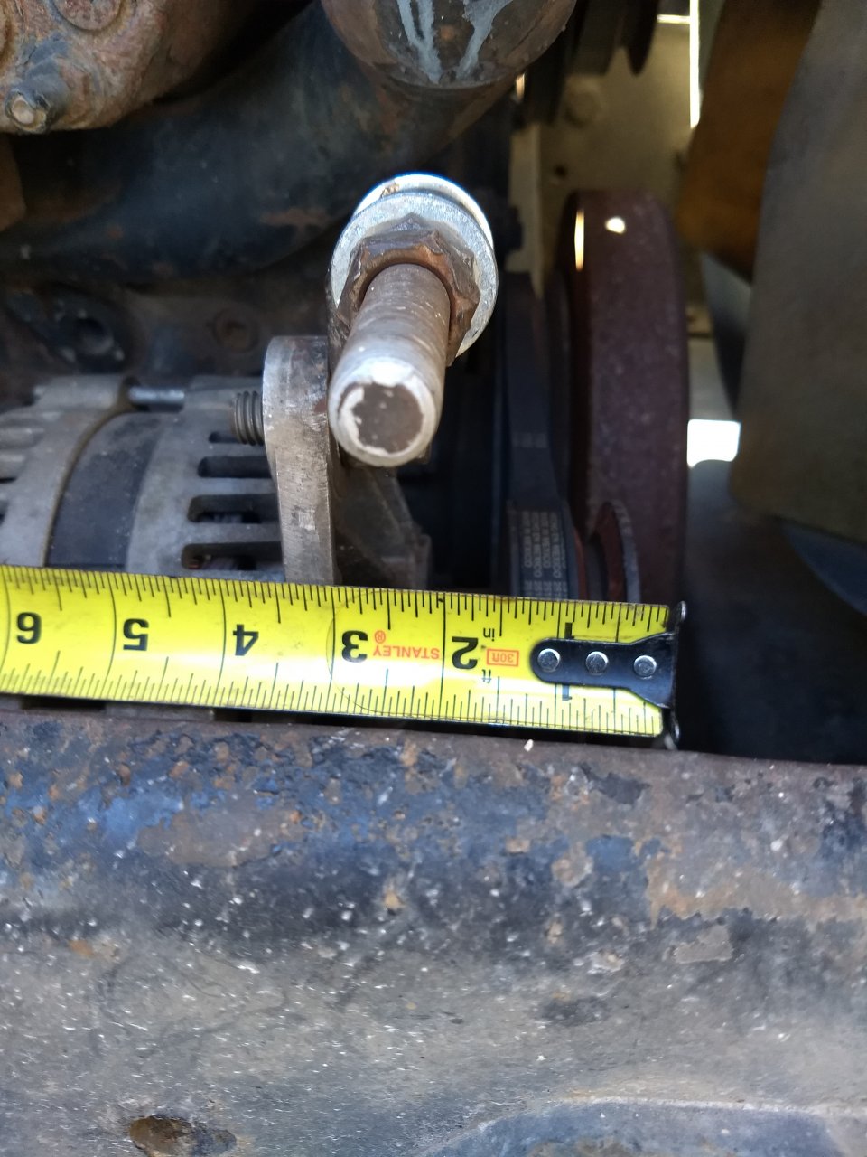

Actually I mounted my alternator on the original mount with the original pulley. I bolted the alternator to the Mount and then bolted the mount to the engine. Where the head of the bolt for the alternator is, there is only a fingernail width between the head of the bolt and the front crossmember, but I can get a wrench on it and it is not against the crossmember.
The bolts for the engine mount went in easily and I had plenty of room to install it.
So I think that I'm done. But check out the photos. It's interesting that they engineered it that the mount on your truck move the alternator rearward and the pulley that you have extends forward.
I'm happy it all fit like it did.
