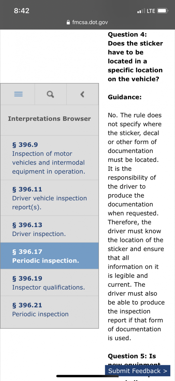

    Got a yearly DOT inspection on my truck because I had blown a brake chamber so was already stuck at a Loves shop. After I passed they gave me the paper that checks everything off and a sticker. Does the sticker need to be displayed somewhere? Is it a DOT rule or is there any good reason to post it?

    12B0D55E-013A-4615-986D-4C85C821B2D4.png I thought they did away with the sticker requirements,don’t have time to look.

    I sticker is not required. Just need paper with the proof the inspection was done.

    Actual posting of sticker has never been mandatory.

    The answer is on the sticker if ya think about it....... all the sticker says is where the inspection report can be found. If ya keep the report in the truck then ya don’t need the sticker.
    For 9 years now I’ve never had the sticker on my truck
