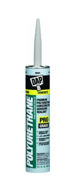

    A blob of polyurethane caulk will keep it from vibrating too much. Polyurethane, not silicone... not butyl rubber... not latex...
