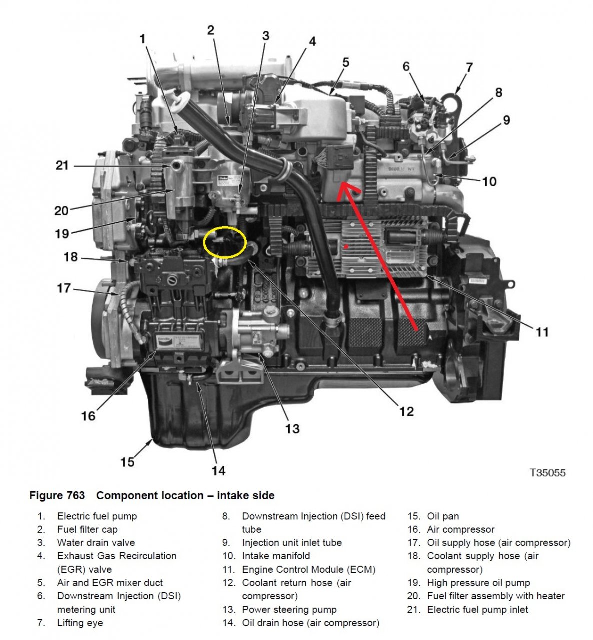

    Now, I know this is an old thread, but where would the injection control regulator plug be located?

    Never mind the red arrow. It's circled in yellow.
